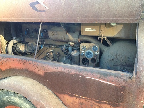

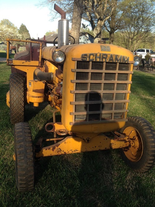

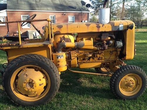

You need a Schramm Pneumatractor or tow behind. I bought this tractor about 8 years ago for cheap and the tow behind a few years ago for cheaper. They both have the same engine and are 6 cylinders, the front 3 are the engine and the back 3 are the compressor. They are both 160 CFM, yes, one hundred sixty CFM.

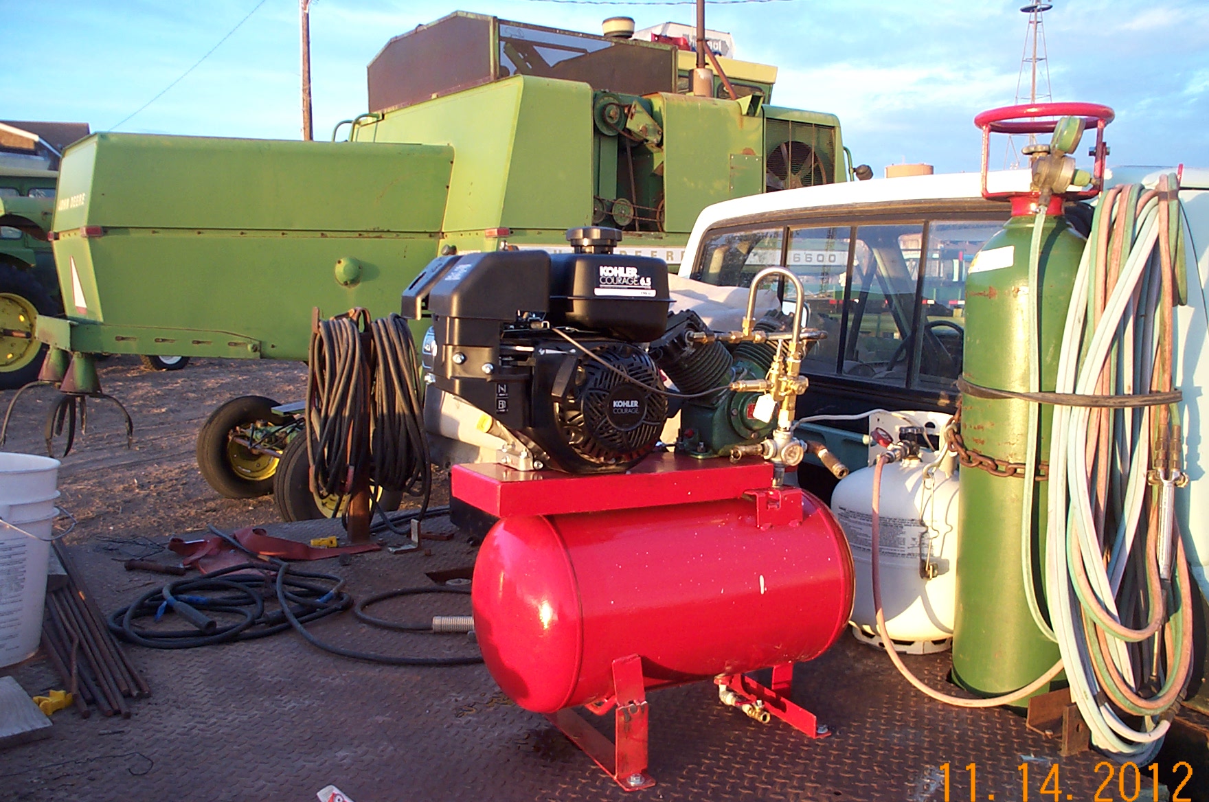

This is a set up I came up with, the compressor was off a old air powered beet thinner, (they were a failure from my understanding), I contacted the current company that has the rights to the compressor, and got information on how to set up and use the built in unloaded,
the small compressor on the truck was made from parts of a few different compressors I had a pump from one a tank from another, and add the gas motor, and a in line unloaded, with a kick down for the throttle. (bought from amazon the unloader)DCP_4060.JPG

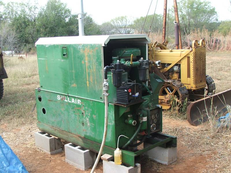

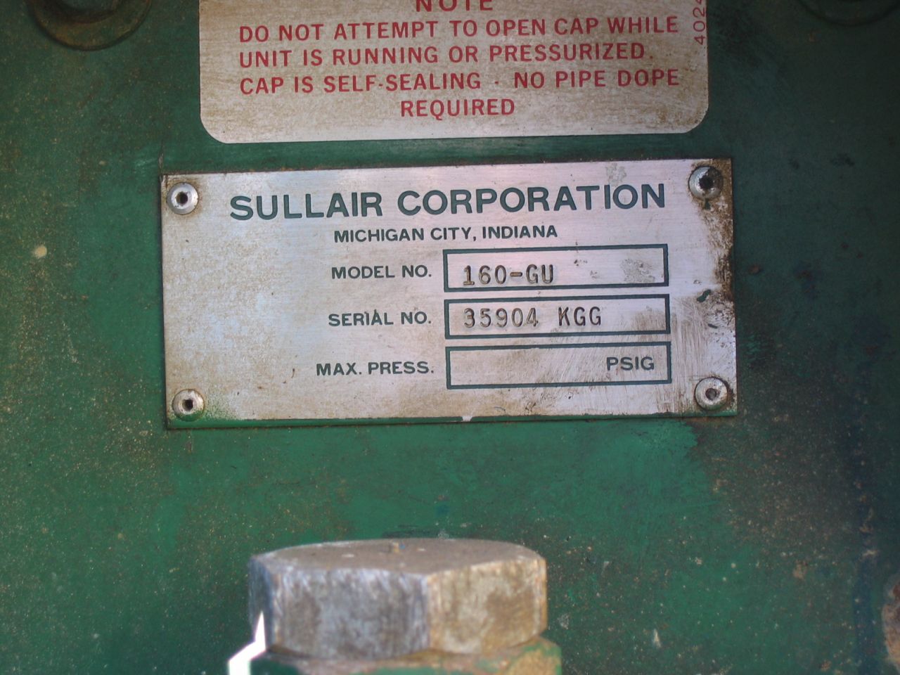

I have an old Sulair 160 for large blasting jobs. It uses a 4-cyl. Chevy engine to drive a twin-screw compressor. I run the air to a 20 gallon tank so I can better control the pressure with a regulator and a filter/drier. From there it goes to my 300lb. pressurized media tank. When I'm blasting car body sheet metal at ~40psi, it barely comes off its idle speed.
