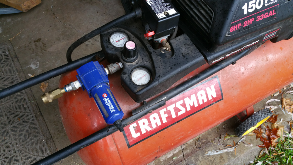

We were given an Sears Craftsman air compressor. No manual but I did manage to find one online. It came with this blue Campbell Hausfeld system installed which obviously is a custom install but I'm not exactly sure what it's supposed to do. Appears to be some kind of in-line filter?
   / Air compressor question #2
It filters dirt and water from entering your tools.
Usually have the bowl is pointing down so you can use the drain valve on the bottom to remove any water.
   / Air compressor question #3
don't know how much good it will do in that position..It should be mounted vertical (drain down) not horizontal

It's filter dirt and water from entering your tools.
Great-- thanks for the info (Kenmac as well). I'll have to see if there's some way to position it correctly. Perhaps an extension long enough to clear the front of the tank.
