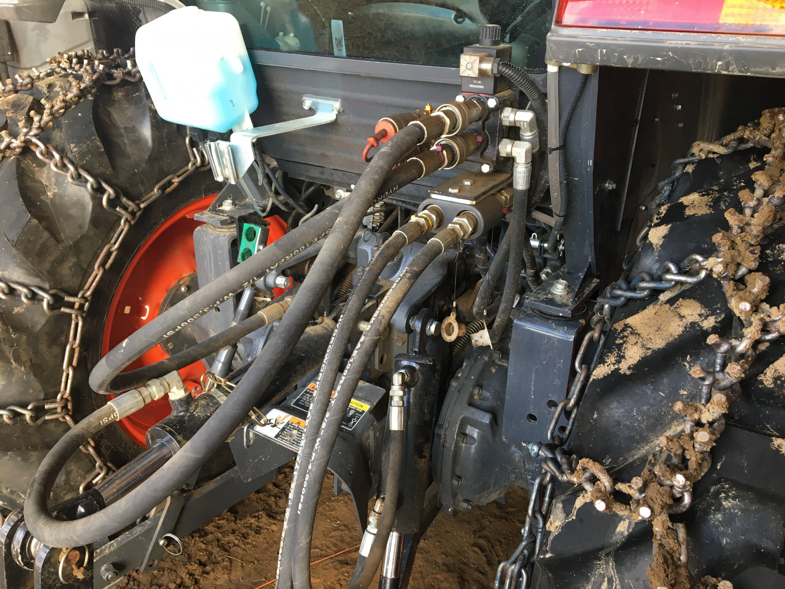

I've been having an issue with the hydraulic top link cylinder and I really notice it when using ground engaging implements and my heavy snow blower. It seems to be an air leak. I watch the cylinder ram extend and retract as I drive along, with no input from me. If I stop and cycle the cylinder to relief in both both directions then the air will bleed out but after a short period of use the problem comes back.
I'm pretty sure I have an air leak but don't understand how air can get in but hydraulic fluid doesn't leak under pressure. Any ideas on how to find the leak, when there is no hyd fluid leak visible anywhere. Also how to tell which side of the cylinder system to check.

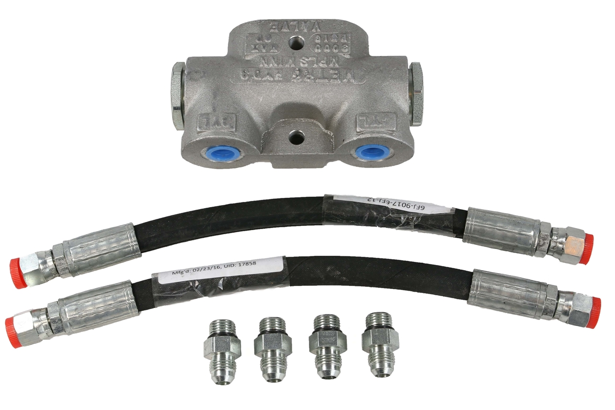

Here is a link to the diverter valve I used.
https://www.princessauto.com/en/12v-dc-2-position-6-way-selector-valve/product/PA0008051799
Here are some pics of the setup. I took one of the rear remotes and ran it into a diverter valve and split that flow between 2 circuits. One to operate the top link and the other to operate my snowblower chute or the rear tilt gauge wheel cylinder on my landscape rake.

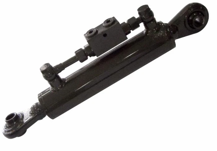

If you add a lock to the top link it could stop the problem;
You can also get hydraulic top links all set up with one;
either of these could likely clear up your issues.

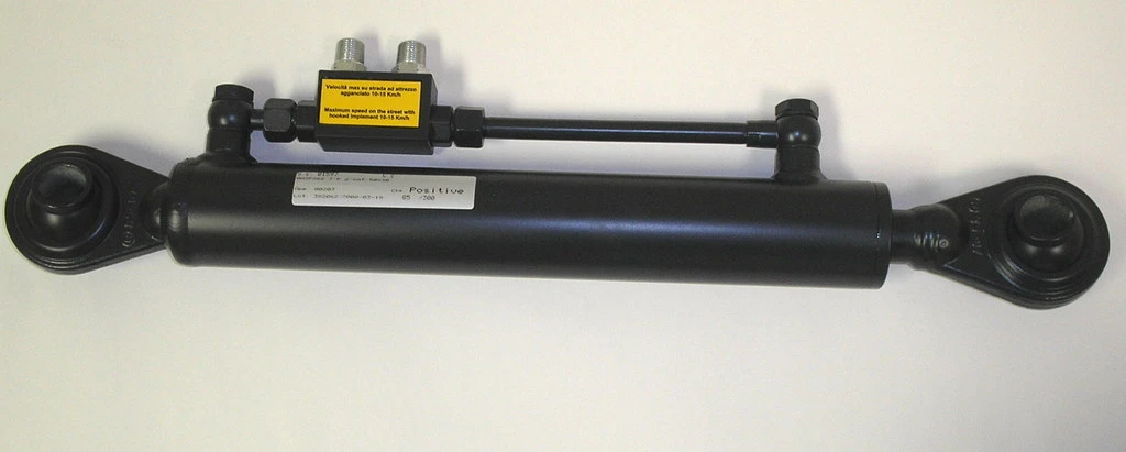

I can't find a top link with the built in lock valve. At least none that are available.
Is a lock valve the same thing as a check valve? If so maybe I can find one of those to try.
