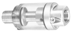

   / AIR LINE EXPLOSION #9
I use an inline oiler that is mounted on the tool itself. That way you only get oil in the tool, not the air line.
   / AIR LINE EXPLOSION #10
Yep, those are a good idea, and by the same token, you can buy a cheap, throw away, dryer about the same size to put on your paint spray gun instead of those expensive inline ones.
