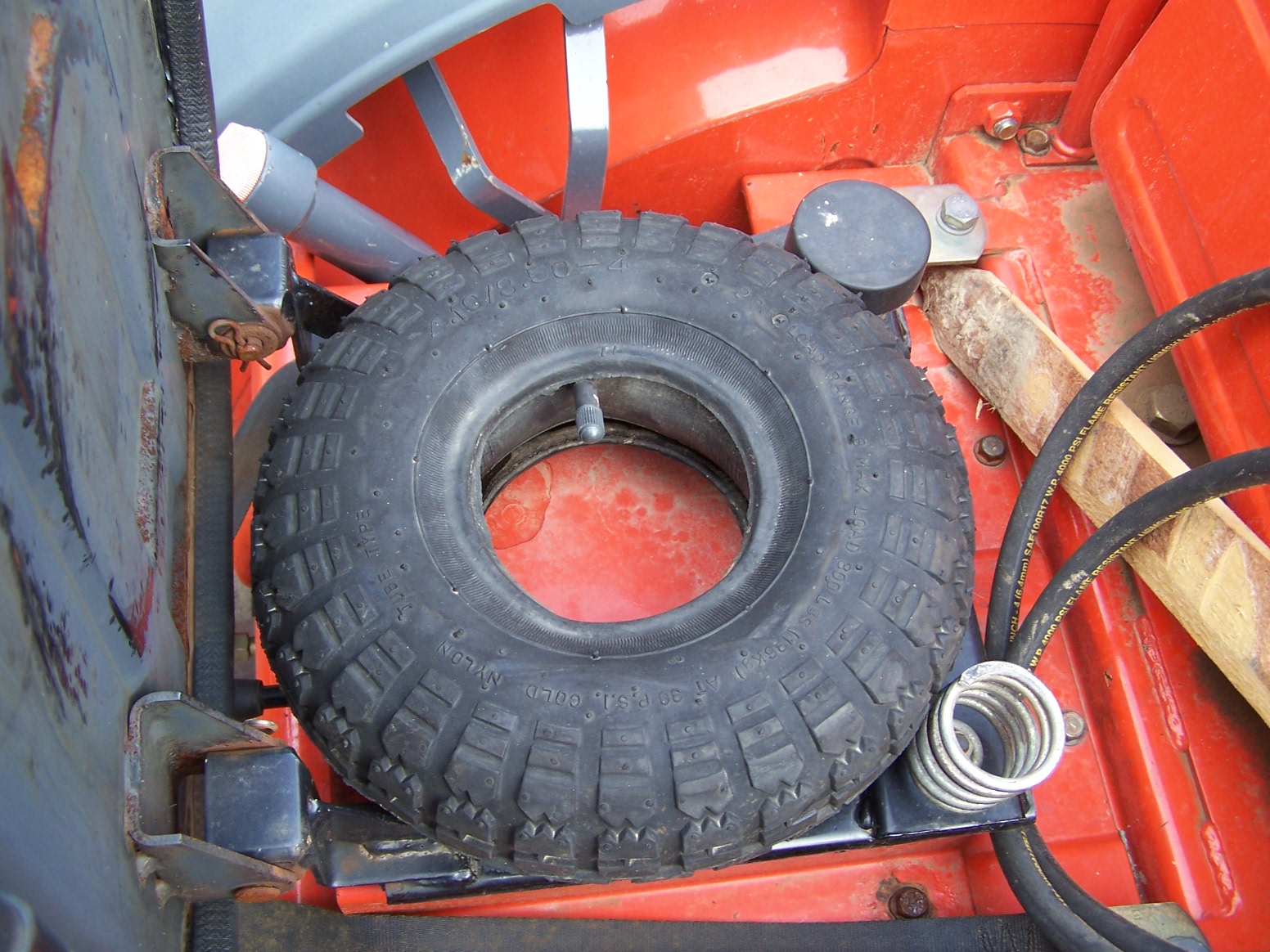

I have been considering adding some sort of "shock absorber" to my seat to mimic air suspension. My Kubota will rattle your teeth in late summer mowing.All the after market seats I have looked at don't hinge which would eliminate my access to the toolbox, hst fill etc on my B7610 Kubota. Has anyone out there seen or done anything like this?

An idea that I use (found elsewhere on TBN a while back) is a small tire - rim removed - all else intact. Keep in mind that I have a Kioti CK20.
Kurt
   / air seat? #3
Check rear tire pressure, sometimes in the summer it can go up, giving a harder ride on the dry ground. Let a few psi leak out, you may see some difference.
   / air seat? #5
Have you tried a spring ride seat? I got them on my bigger fords... feels -real- nice.. even in a bumpy pasture.. has arm rests and all. Can get them from places like northere tools.. maybee even TSC..e tc.
