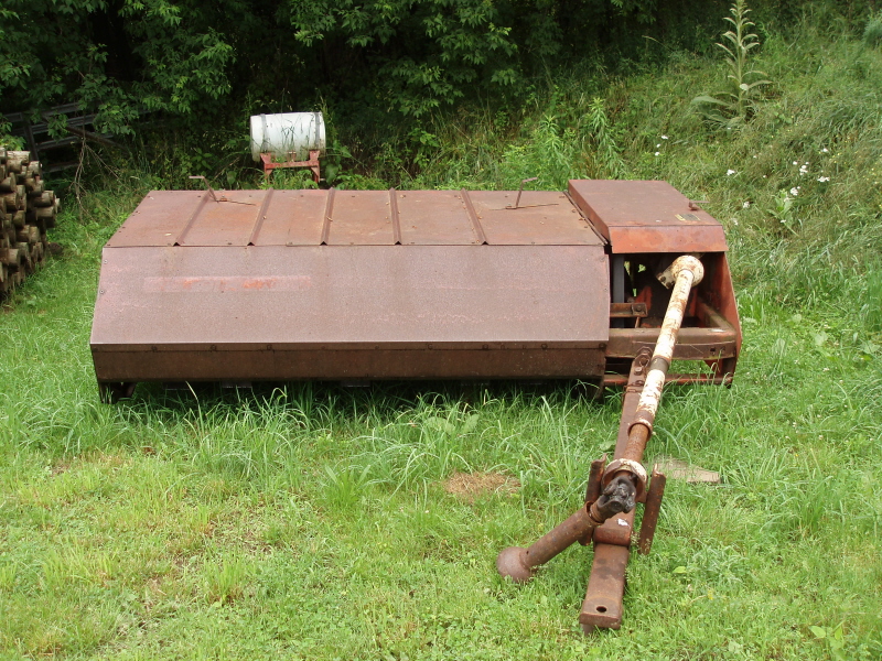

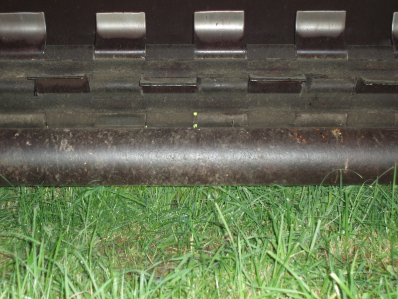

I've wanted a flail mower for years, but haven't found the right one at the right price. Your impressions seem spot on.
FYI, my hay mower is a New Idea 272 Cut/Ditioner (see pictures). It is a 7' wide cut flail mower on steroids (overall width nearly 10'). The flails are ~ 5" wide and are made of some thick steel (never measured, but I would say 1/4"). On the rare ocassion that I hit a small tree (1"), it strips the bark and leaves the majority of the stem. So heavier flails are not necessarily the answer. Sharper flails and slower ground speed will give a cleaner cut.

Thanks for the info on that. Those cutters are pretty massive, I'd have guessed they would have chopped 1" material like an ax. I'll spend some time replacing/sharpening/flipping mine over the weekend and see if it whittles through the thick stuff better. I'd guess you're right about ground speed. Since all sides of the stem are being stripped it would seem that the flails are making contact all the way around, hence more time might allow them to whittle things down to mulch. I'm also thinking that letting these stripped stalks dry out should make them more brittle and more readily cut. What dry, woody stalks I have seem to get ground up better than green woody stuff, which bends over more.
