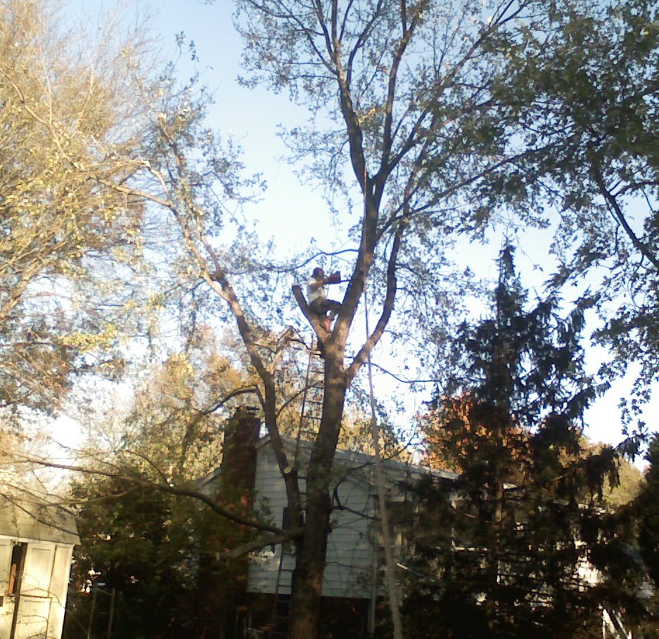

I had a 20" maple in the backyard. The neighbor lady, very nice person, had a deep seated fear it was going to fall on her house.
So I started making it shorter.

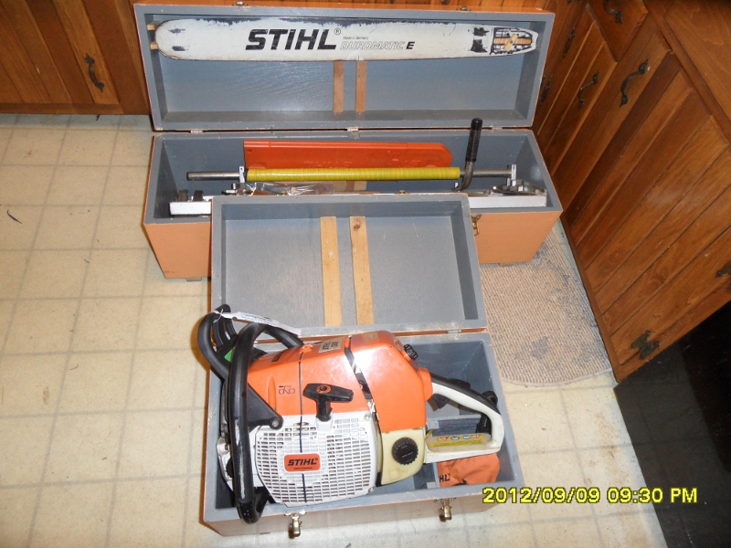

First with my old Stihl 021
I then purchased a used 660 ($600 w/42"b&c) and an Alaskan Mark III (~$200) and proceeded to make it both shorter and thinner
After a year of drying I used most of it for shelves and a small table for my chain sharpener.
So my TOTAL equipment investment was about $800 in saws (which are used frequently).
And I'm glad that some people discard CSM because one guy that did sold me a lightly used Stihl 088 (120CC) / Alaskan Mark III setup for $450.
088_just-bought.JPG.

Someone's not afraid of heights, do you have the CSM aluminum rails or do use ladder or 2x8 for first cut? Yup cutting down hill is a good tip.
