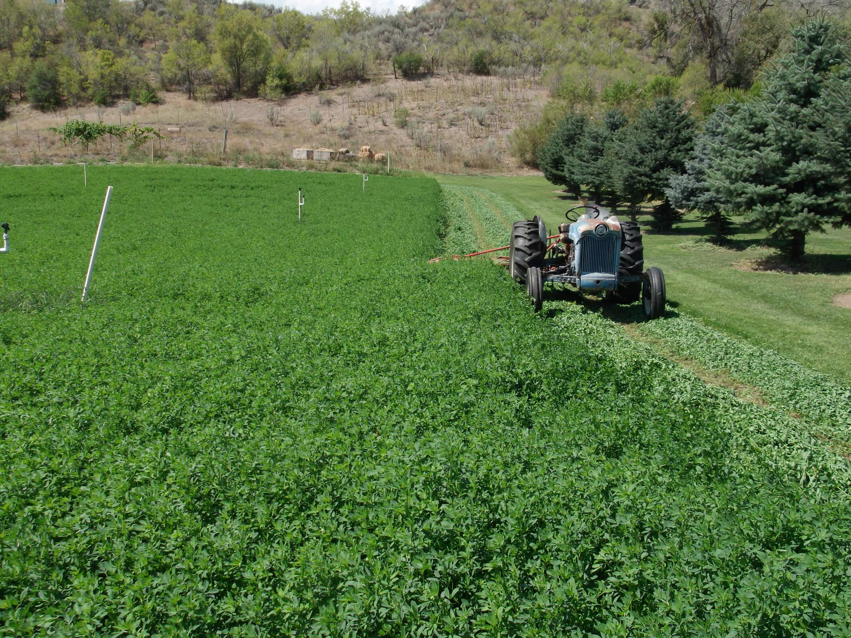

Dan, morning.... Have the soil tested for nutrients... plan on fertilizing as suggested in the soil report... I disced my field and planted Piper Sudan Grass because the field was low in organic matter... cut every 2 weeks with a brush hog (to 6" height) as it grows 1 1/2-2" day.. fertilized every month with urea... Sudan needs Nitrogen.... Irrigated... then disced and spike harrowed and seeded in the fall.... The sudan is reported to add up to 10 tons/acre organic matter and suppresses weeds..... This is my alfalfa field at 3 years... no weeds... cut every 30 days depending on weather.....
   / alfalfa hay
Good looking field.
