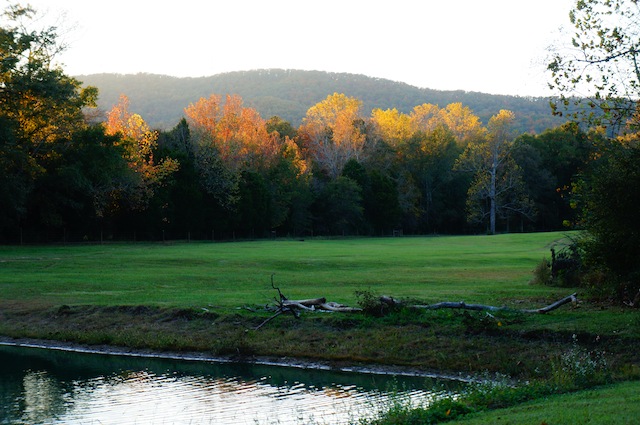

I'm not looking to turn a profit. I'd like to do this for myself and to have fun. If I make a few bucks on the side then that's great! I've attached a photo of our entrance to our land. This was taken as the sun was going down last fall. As you can see I take pride in our land, but even with that said, there is still a never ending job to be done with the land.

Nice looking property.
