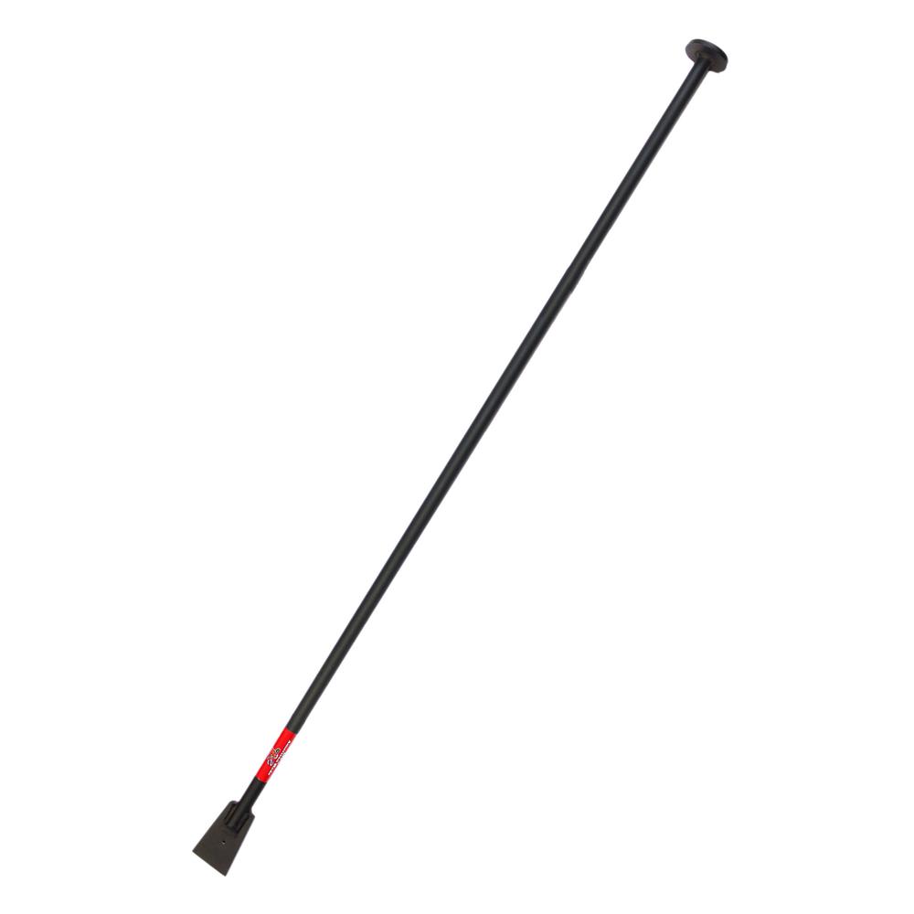

If the roots are right in the middle of the hole, they can easily stop the bit, but if they're not too big, tilting the auger briefly can get it to bite anyways.
If you don't want to tilt, try a digging/tamping bar (chisel end) just a bit to chop it up -
