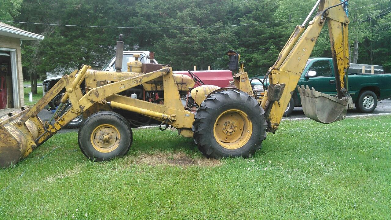

Just wanted to let some folks like myself (not very experienced with tractor hydraulic oil) know that it is NOT all created equal reguardless of label specs!!
1st little history on my 1966 Diesel case 530 Torque converter Constuction King- I bought this used for 2000.00 in working (leaked everywhere) order.
The man I purchased it from said he got it off a local farmer and it barely moved. It just didnt really have the push power or power to push or pull itself outta a hole.
So..for 2300 I figured why not. He said he topped all fluids off with tractor store stuff..(cause label said for use where hy-tran is).
I drained fluid from everywhere once I seen it had no real power to wheels...noticed filters missing to torque converter...
replaced all filters and flushed all conpartments with diesel fuel.
Then bought napa 80/90 weight for differential
then purchased 80.00 case hy-tran for torque converter / transmission area.
Maybe I got lucky...But this tractor now has plenty of power.. Just a FYI...Buy the right fluid especially when it comes to these older tractors..My opinion, but well worth the 80.00 with some fluid left over. Thank god I didnt have to spit the machine..Ouch..my back hurts just thinking about that..haha

No one can say what was in the unit, only that it was "topped off" with "tractor store stuff". Not much to go on regards comparisons.
with filters missing, one can assume there was little care of just what went into the sumps.

yeah..i was puking..a nice napa filter was 13.00..crazy how idiotic ppl can be..or lazy, either way..barf
   / All hydraulic oil is NOT created equal!!
agree..it was gold in color..seemed like hydraulic fluid not atf..but who knows

thanks..I think I got very lucky on the price and timing...the guy I bought from fixed New hollands for a living outta his shop and stumbled on this somehow for free.. He knew nothing about case machinery and wanted to unload it. Regardless of the lack of filter situation and not knowing the oil in it at the time of purchase. I can definately say I'll never put anything other than Case fluid in Hy-tran area.. I'm shocked It doesnt have bad plates or worse.. IDK.. I'm new to this but for the little money extra WHY NOT...I use tractor sup stuff in the backhoe/loader stuff and it works great!! Just not in the area I needed it too. I can only go by what the guy said about topping it off with it from TS... but as cheap as the previous owners were..who the **** knows what they put in there..
I just know it actually pushes dirt now..lol
And thanks to Bukitcase and Rutwad I learned my pin size on my hoe bucket and picked up some cold rolled steel. This is a home machine and not commercial at all.. My toy/huge helper..lol . One day I'd love to restore her to her glory...but thats a long ways away..lol. This site is awesome and full of great info as I learn..I definately appreciate all comments and help..thx folks
