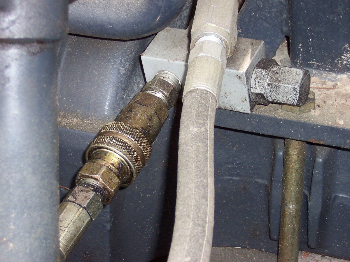

It sounds like you are dead sticking the cylinders. I don't understand how that could break the cylinders.
I have a cheap Jinma hoe that I adapted to my 3510 and if I dead stick it the hydraulics squeal loud in protest!
I put a pressure relief valve in the hoses for my rear connectors to protect my system. The pic is of the valve, I plug the pressure line into the return when the hoe is not on the tractor.
