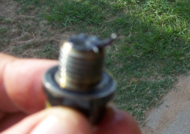

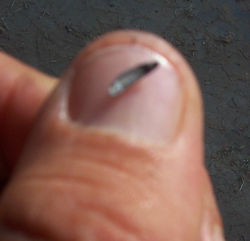

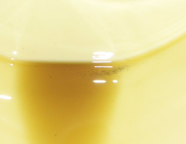

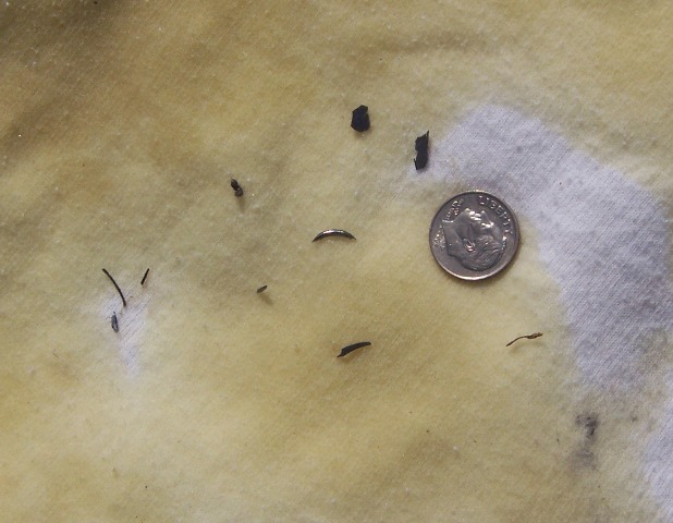

The noise quit the day before I was to take it in. I was advised to drain the fluid and see what comes out.
What ya think?
   / All owners ... Not only Branson... All tractor owners .. I need your opinion... #10
Your pictures are blurry when they are enlarged; try photographing these in macro (close)setting but I cant really tell by your photos so you may have additional problems.. Your clutch issues definitely sound like clutch disc/ pressure plate/ throw-out bearing related. Maybe all the parts weren't replaced and one worn part was left. I have heard throw-out bearings sounds that were like squealing to nothing but just a slight rumble; or where the noise starts or stops when pressure is put on or taken off the clutch. Many times, throw-out bearings are blamed when it is actually the transmission main shaft/ internal trans bearings/ noise; the trans bearings become silent when the clutch is depressed and the trans comes to rest.
Is that oil and debris from the trans axle?
Was the trans axle ever drained and the strainer cleaned?
If you are describing your symptoms correctly I would say its clutch (whole). Nonetheless, the draining of the oil should have nothing to do with the clutch since I believe your clutch disc is dry. If that debris was in the bell housing I'd say you have disc rivet, damper spring (producing chatter), or pressure plate or throw-out bearing issues, anyway your last statement sounds like clutch chatter. If you didn't have any odd noise or troubles in the trans I would say the debris could be casting/ tap debris. If everything internally in the trans axle is operating properly I would do a clutch (meaning disc, pressure plate, and throw-out bearing) first.
