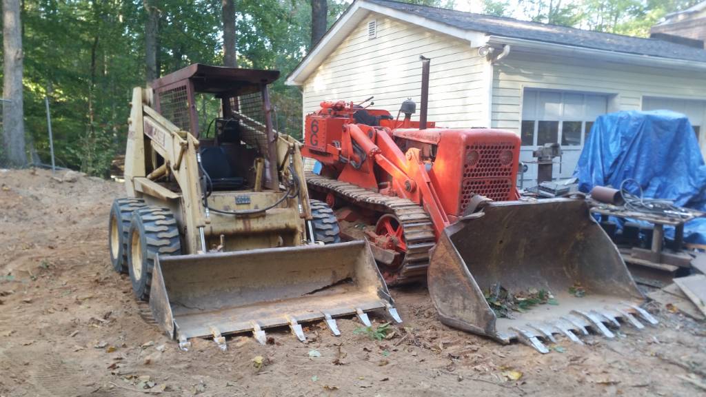

Looks like I知 getting an Allis H3 track loader to play around with. Does anyone know if I can swap the bucket for a dozer blade?

If you remove ALL of the loader and have ALL of the dozer blade parts you can convert, BUT you also have to have dozer track pads and NOT loader pads! loader pads on blade tractor are useless----- no traction!
   / Allis H3 #4
My buddy has a HD6 that I used to help clear/cut the pad for my shop. He welded round bar to the pads to give it enough traction for the rippers on the back. You can still get a lot of parts for thr HD6, not sure about the H3.
I just used the rippers to break up the ground and moved it with the skid steer. 826390634.jpeg
