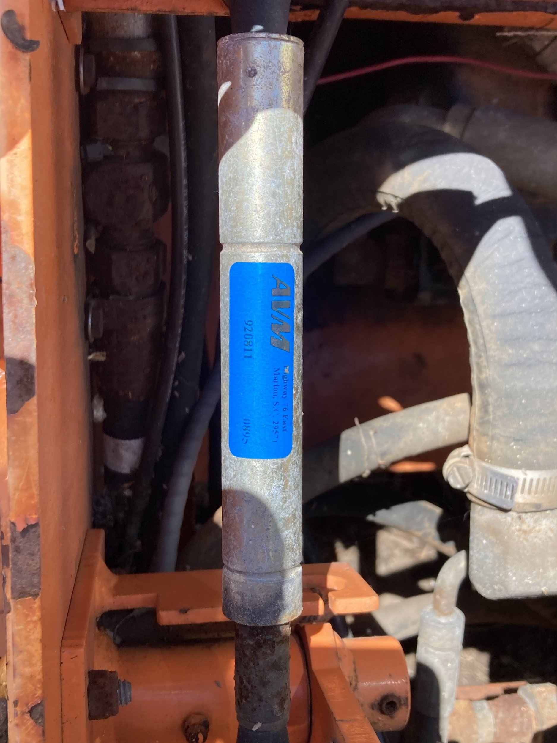

Hello,
Trying to get my allmand brothers 425 Back in service. It sat for a long while. I need to replace the hydrostatic drive damper for the pedal. It’s listed as part number 920811 made by avm. It’s listed as a self centering damper. Any info on a suitable replacement would be appreciated.
Thanks
Andrew

Try avm directly or allmand tractor parts

Hi thanks for the reply. Problem is allmand no longer makes or supports the tractors, and avm does not have any phone numbers I can reach them at.
I was able to free up the old one and here are the length specifications from the centers of the mounting screws:
neutral length: 8 3/4”
full fwd length: 9 7/8” ( extended)
full reverse length: 8 1/4 “ (compressed)
if anyone knows of one with about these specs please let me know. I can always redrill the mounting hole to accommodate one with similar specs.

I found that guden lists a self centering damper model scd12 and scd9 ( for 12 and 9 lbs of force), but can’t locate either because they said they don’t have a suppliers for these anymore

Did you have any luck finding the damper? I need one for my TLB325.

Checkout liftmatic self centering dampers

I forgot about this and started looking back into it. I changed a]ll the hoses on my allmand after one ruptured.
Now i need the self centering damper. Did you ever find one that works?
I see a few that may be usable, but was looking for some input.
Thanks,
Andrew

Mine is still working the way it should so i never followed up on it but always thought i would use old school springs and small turnbuckles if mine stopped working some trial and error to keep it from creeping.

Thanks for getting back.I’ll probably do the same if I can’t find the part.I have the original damper on it but it
Does not center anymore.
