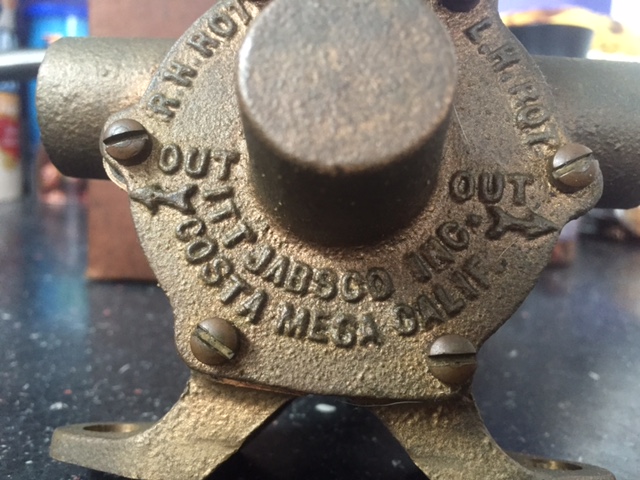

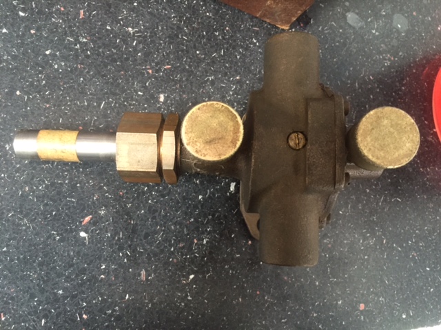

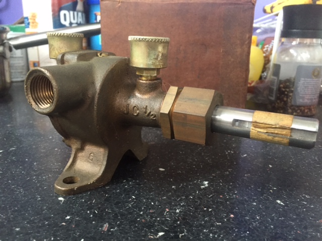

This old Allstate water pump, re-manufactured for Ford Products was found cleaning out an old house in Detroit. Research on google etc has been no help and I am hoping someone on this forum can help me identify the part and help me determine what to do with it.
Knowing Ford had a big role in tractors I'm hopeful there may be a connection. It does not appear to me to be for a car application because of it's mounting bracket. But boy oh boy have I searched.
I would really love to know what this pump is for and how or where to sell it.

You don't think someone put it in the wrong box?? I have dealt with ITT Jabsco for industrial pumps and that is a "transfer" pump that you have pictured. In agriculture it would be used in spraying operations mainly but they are like me they just do what they are told
   / Allstate Water Pump Identification
NC419N, You are correct. I got so hung up searching the part number and name from the box I didn't think to look at the markings on the pump itself. Silly Me! Yes it was in the wrong box and Jabsco still has it listed in its parts catalog as a raw water pump for marine applications. e.g. engine cooling or wash down. Searching Jabsoc etc. on Ebay reveals that there are many of them out there and they range from $75 -300 in listing price. What surprise goodies will I find in the next house??????
