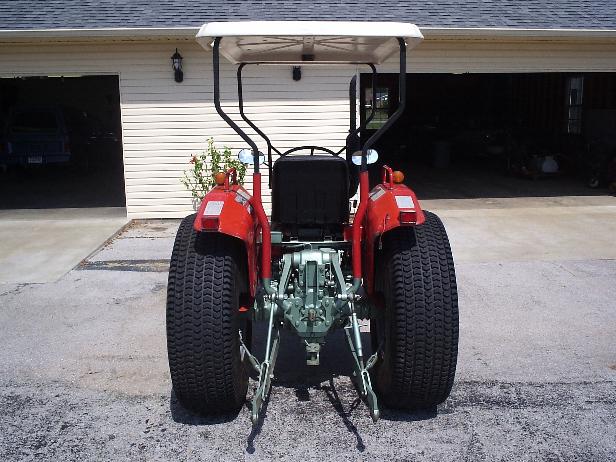

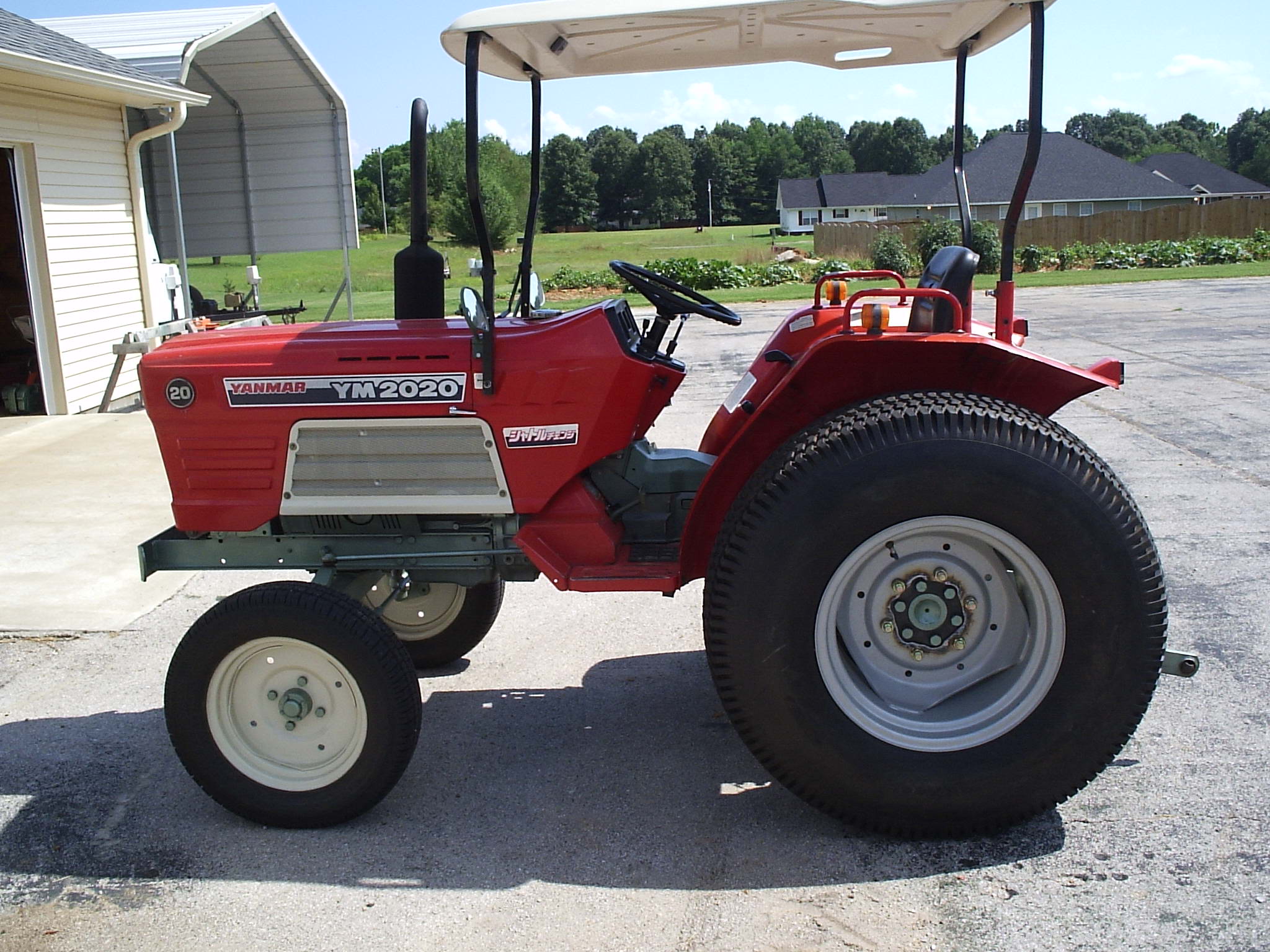

Got the wheel adapters made and turf tires installed. Now all that's left if dress the wheels a little and paint them. Then I'll be done:D :D :D OOPS forgot about moving the FEL from the 1700 to the 2020.
IT NEVER ENDS!!!!!!!

They look really nice! Bet you will be happy with those for mowing.
   / Almost There #3
Nice Sneakers ! You won't be tearing up that nice lawn anymore !

Eddie ,who made your adapters ? :confused:
   / Almost There
A machine shop between Athens and Huntsville, Al made them for me. They did a great job.
   / Almost There #6
What are "wheel adapters"? Will those turf tires fit on any 2*** model? I'm looking at a 2*** model mostly for mowing and some FEL work. Will these tires still get enough traction for FEL and maybe some plowing/tilling of small gardens?
Nice looking tractor!
   / Almost There #7
"What are "wheel adapters"? Will those turf tires fit on any 2*** model?"
That's what "wheel adapters' do for you.
   / Almost There
Makes another wheel fit your bolt pattern and size.
   / Almost There #9
Did the adapters cost less than hey wheel would make wheels ?:rolleyes:
   / Almost There
I didn't check with Hey Wheel, but the machine shop made the adapters for $50 each. I really don't think I could get wheels that size made for that price.
