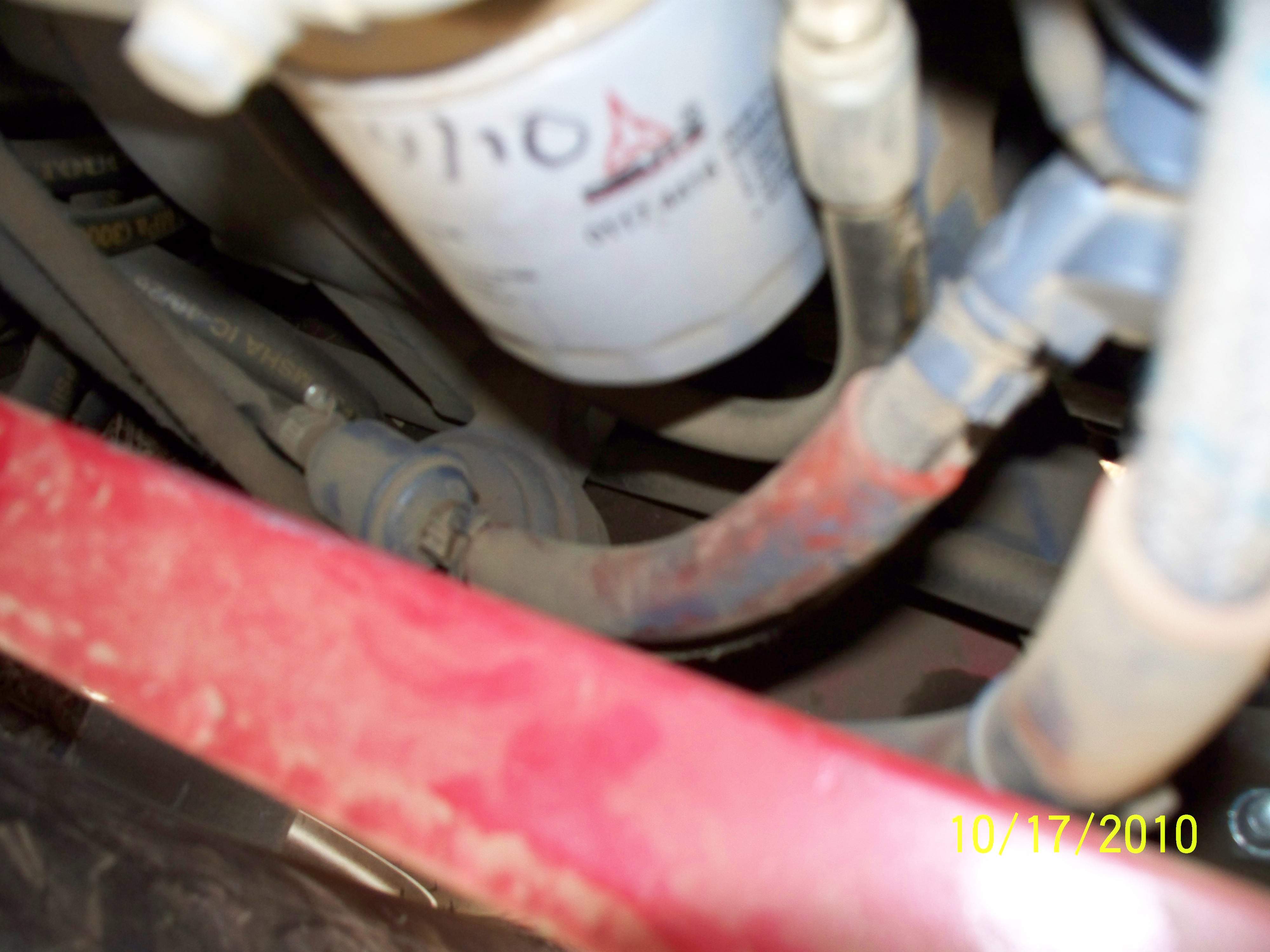

Hi, i have a 1430 and has anyone found a alternate source for the fuel line from the inline fuel filter to the engine? i want to replace the inline fuel filter. It looks like a braided type of hose and a crimp on connectors to connect at the inline fuel filter and at the engine. i called keith at PT and he gave me a price of $22 per ft for the hose and i would need to order 2 ft plus whatever else to make up the $50 dollar min order. Also it looks like PT put on a regular hydraulic hose from the gas tank to the beginning of the inline fuel filter. This has a regular hose clamp at the input to the inline fuel filter and a hydraulic fitting at the bottom of the gas tank. Has anyone replaced that with a regular fuel line? Again Kieth quoted me a price of $22 per ft and i would need 3 ft if i wanted to replace that. thanks in advance for your input and advice.

I just brought the piece to my auto parts store and bought some. It was not very expensive.
You can go to a local hydraulic hose place, and they will make up a replacement for about $17.
I personally would just replace the fitting on the tank with a normal barb fitting and use 1/4" gas hose from the local auto parts store.

I know I don't know as much about this as I should but he has a diesel and it uses a much higher preasure fuel system than a gas motor. I think he can't use regular gas line.
   / Alternate fuel line from inline fuel filter to engine #6
On my 1850 the hoses are all standard fuel hoses. I don't think high pressure hits in the system until after the pumps you see on the side of the deutz.
   / Alternate fuel line from inline fuel filter to engine #7
This section is all low pressure, ~ 1psi. The only thing to be sure of is to get diesel rated fuel hose. Easy to come by.
The high pressure portion of these engines is all in metal tubing.
