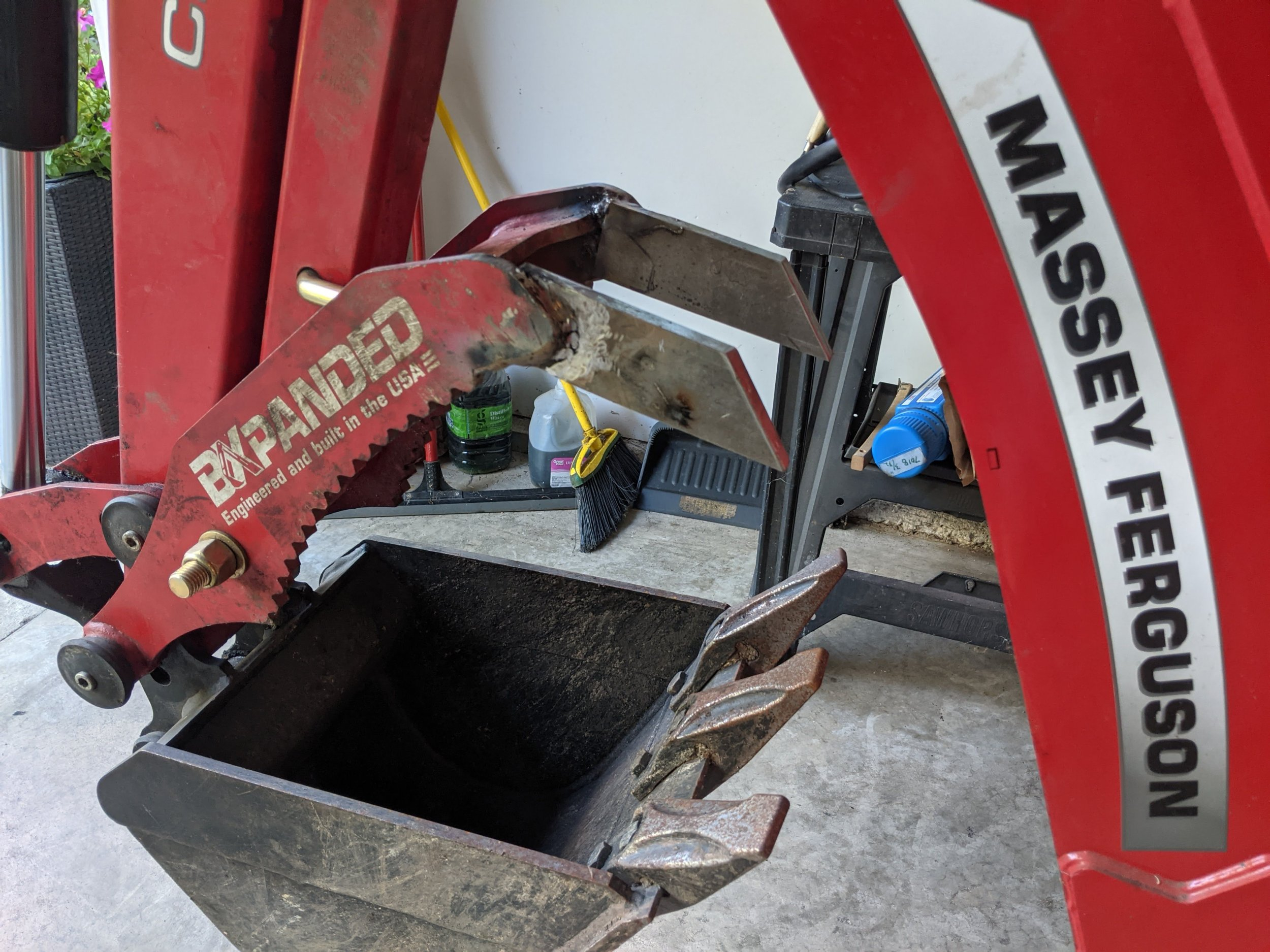

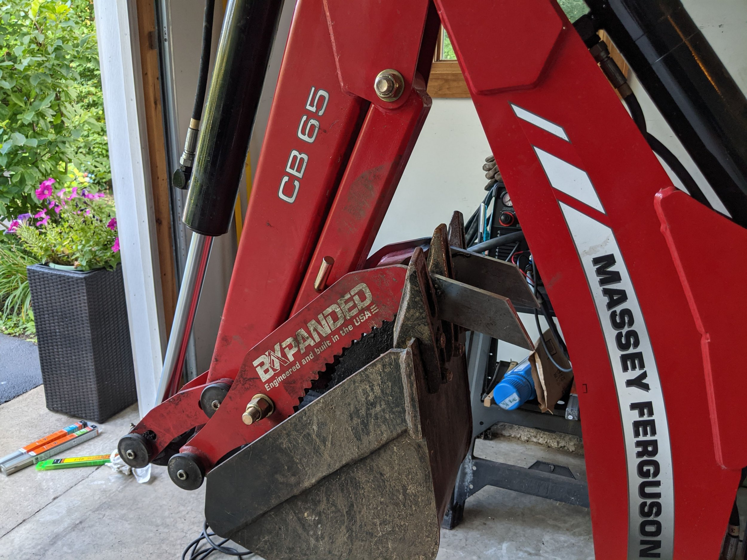

I welded some tusks on my backhoe thumb:
And now I have a grapple:
