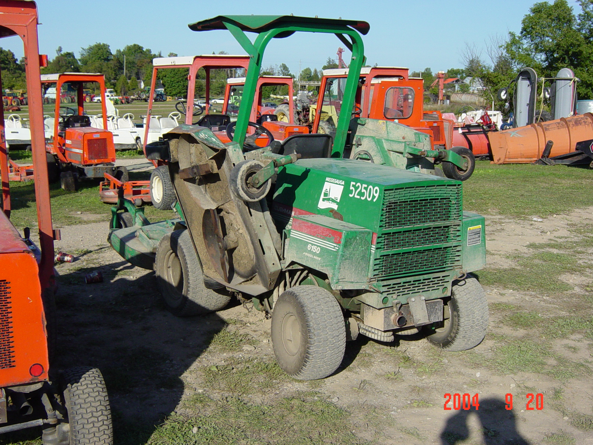

I got one of these because I have a lot of grass to cut and have better things to do than cut grass. They are rated at something like 80 acres a day. I don't know if that is in an eight hour shift or how they figure that, but it can cut a lot of grass. Makes pretty much anything else seem like horse drawn!
56 HP Kubota, ten foot cut, 4x4. A real pleasure to operate too! Now cutting grass is just something I do, here and there as a side job. Another nice thing is that you can mix and match the decks for narrow places.
