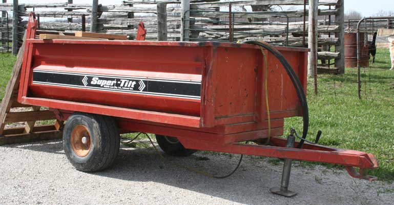

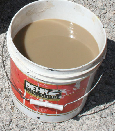

Here why you should always flush the hydraulics on used implements. I purchased a dump trailer a few weeks back at an auction. The owner told me he did all his own maintenance and and said the oil in the cylinder was clean. Well today I finally got my rear remotes installed and hooked up the dump trailer and remembered someone saying to flush the old hydraulic fluid from used implements before hooking up the remotes. I did just that and this very dirty fluid came out, almost seven liters (almost 2 gallons) of it.

Kind of looks like it had a good bit of water contamination. Good thing you flushed it out.

I would like to know how you flushed it, did you just take fittings off both ends and some how pump clean through
and that color is just moisture in the oil, it will rust if water is more percent than oil

I removed one of the quick couplers and attached the other to the tractor. Raised the trailer with the other hose in the pail. I then reversed the hoses and repeated the whole process. I repeated this until I was getting clean oil from the hoses. I hope this was enough.

Yes it was, Thank you very much and thats easy
