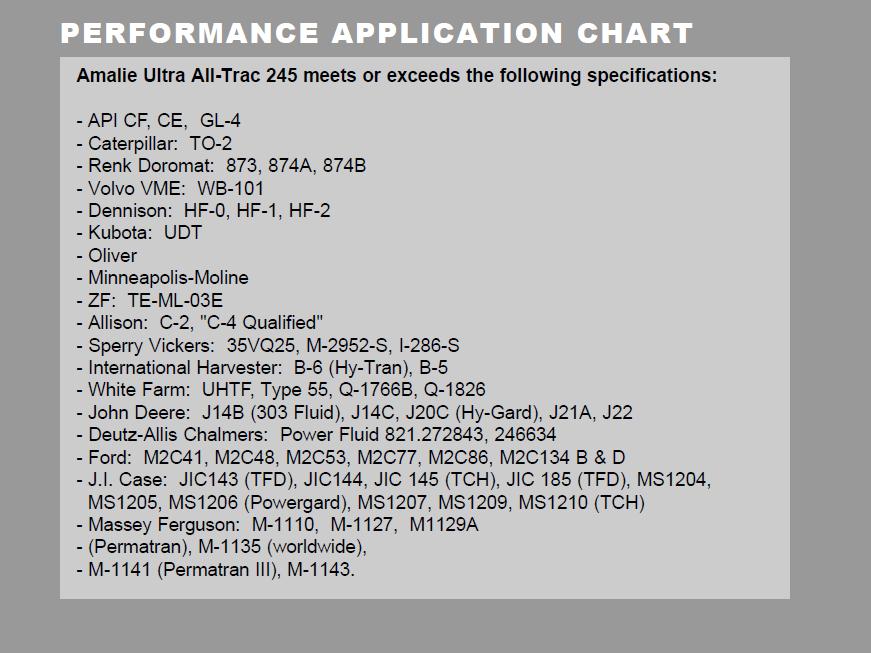

   / Amalie All-Trac 245 Hydraulic Oil #9
Is there an Amalie Super UDT All Trac 245?
My comment was based off of Amalies website:
re. Kubota SUDT, it is a dino multiweight, it's not a synthetic.
   / Amalie All-Trac 245 Hydraulic Oil #10
I pulled that off the Amalie web site if you google and you see Amalie 245 it could lead you to someone else's web site that the specs are wrong or out dated that's what I did the first time, when op had mentioned that the oil was expensive I just went to the Amalie website and got it through there,a lot of times I google and end up in a third party website and the info is wrong
