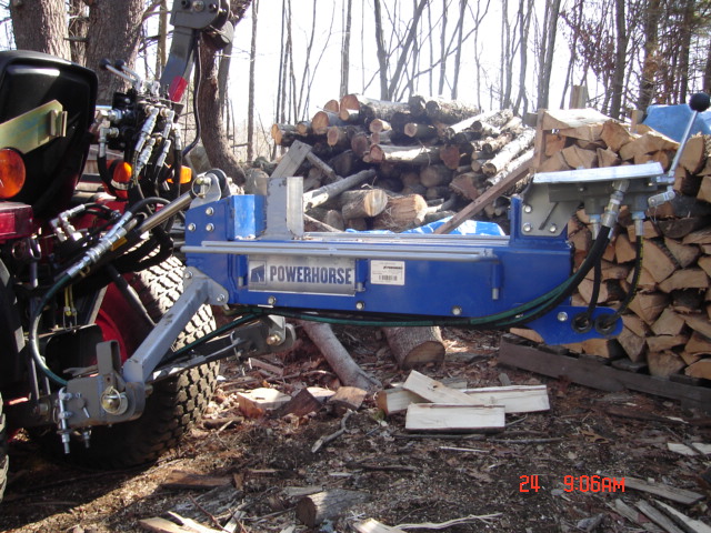

A few weeks ago I went down to the NH seacoast to see one in action... It was a Powerhorse brand on the back of a Kubtoa (L series?).
It seemed well made, the owner was quite pleased with it. It wasn't real fast, but if you're just doing your own wood that might be OK; I thought it would be fine for me. On the positive side, it didn't require a high GPM flow of hydraulic fluid --would work on my GC2310-- and had plenty of power. The blade also was double-ended, so it works in both directions- no need to return each time.
I decided to borrow a splitter instead, but if I didn't have access to one I'd seriously consider it. There's a thread somewhere on it, with some pics, but I'll post one here from my visit.
