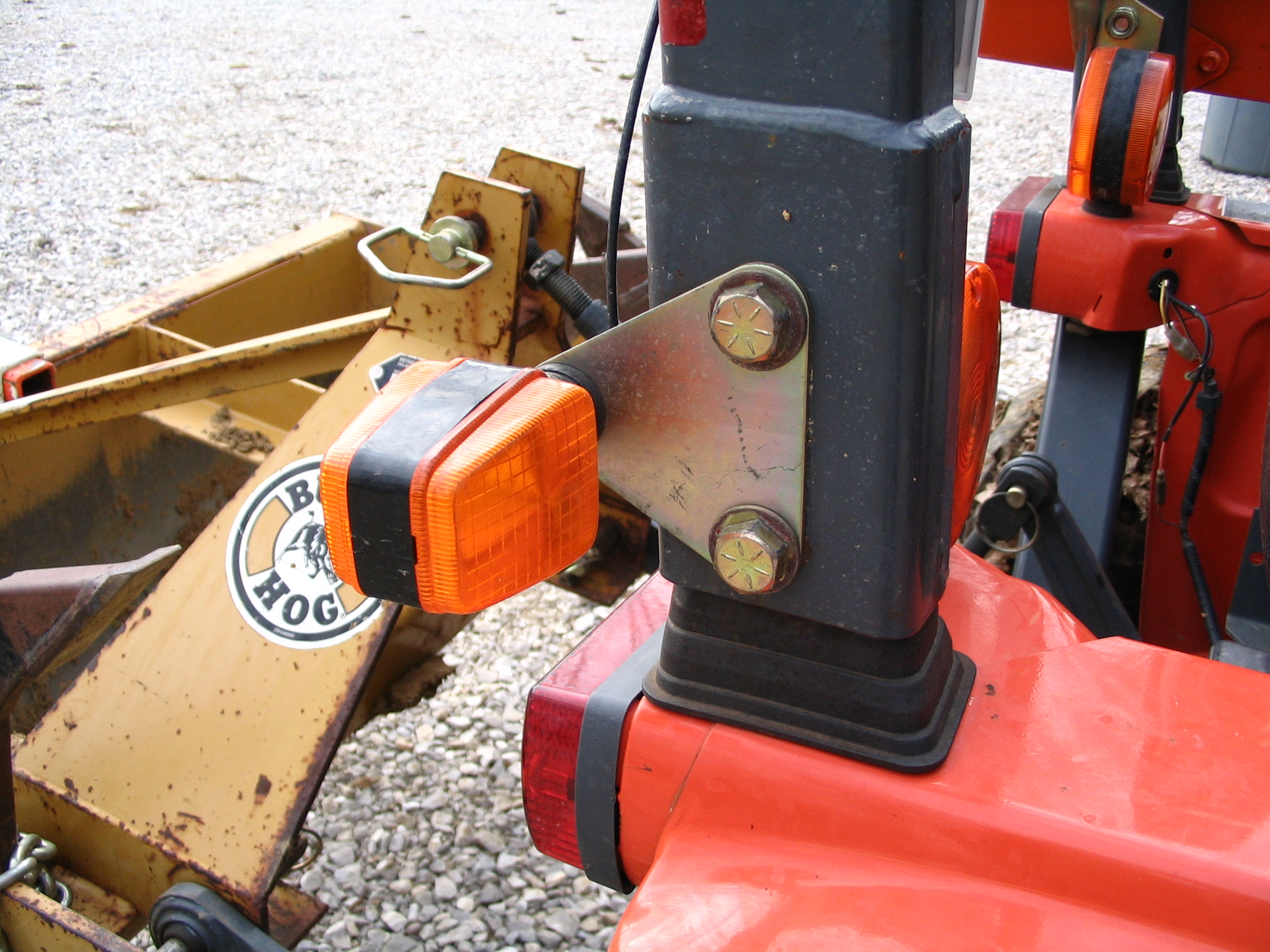

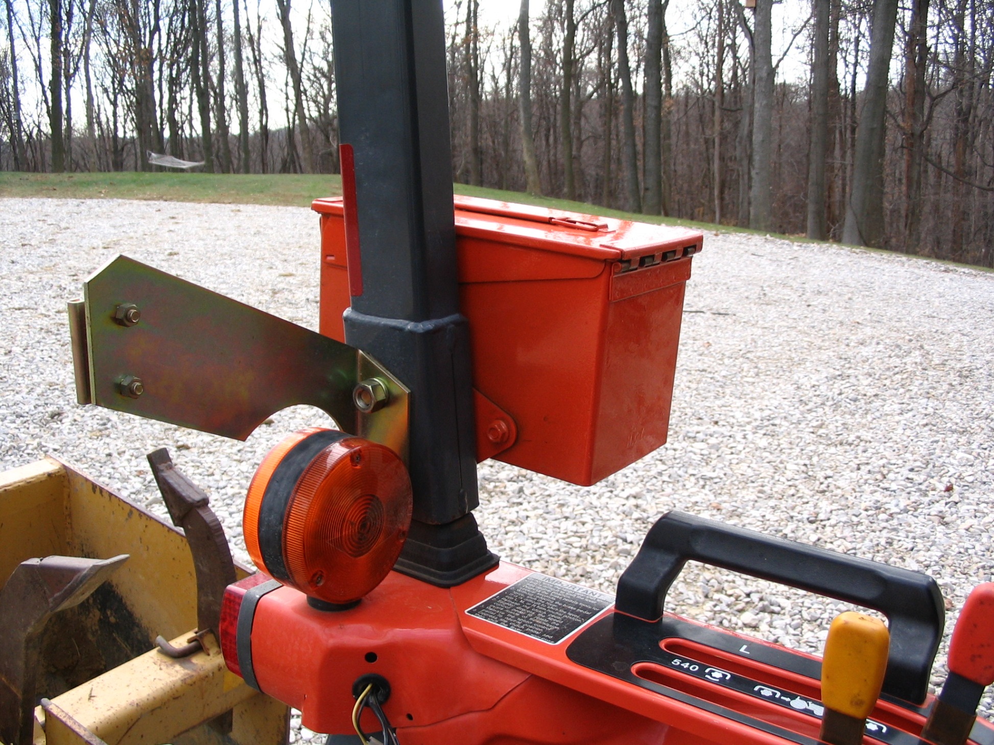

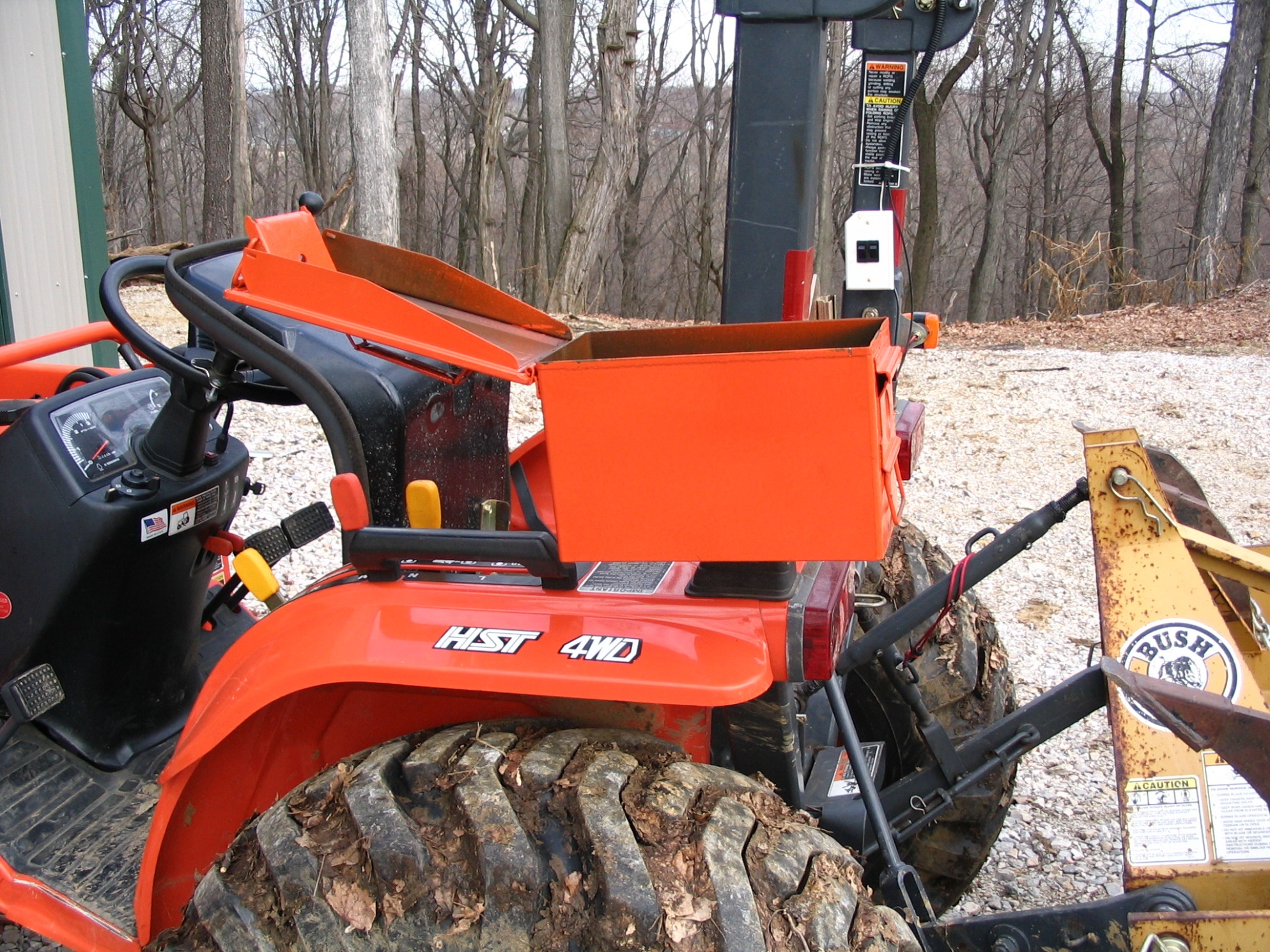

I bought a medium sized ammo box a couple of months ago and looked for a good place to mount it on my tractor. I looked around the front and the loader areas and found no place to mount it. Finally I got tired of tripping over it in my barn so I searched once more. Came up with a way to mount it to the rops bar without drilling and with little effort. I removed the hazard light that is outside the rops bar and reversed the bracket so that it faced forward. Drilled two holes in the ammo box and put the bolts back in and wala done. It is the perfect height and is easy to get to even when seated. Here are some pics

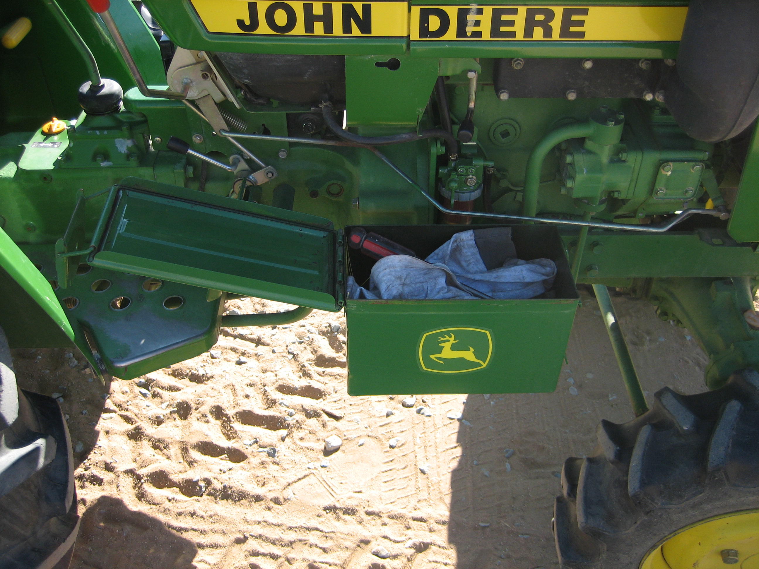

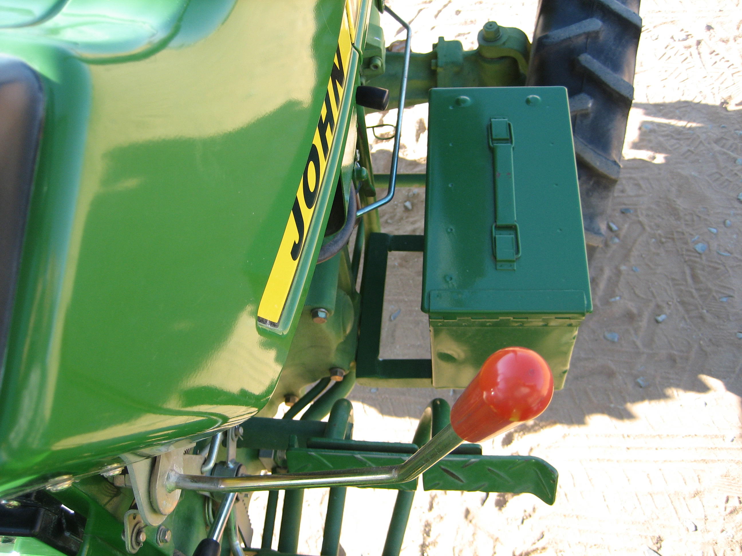

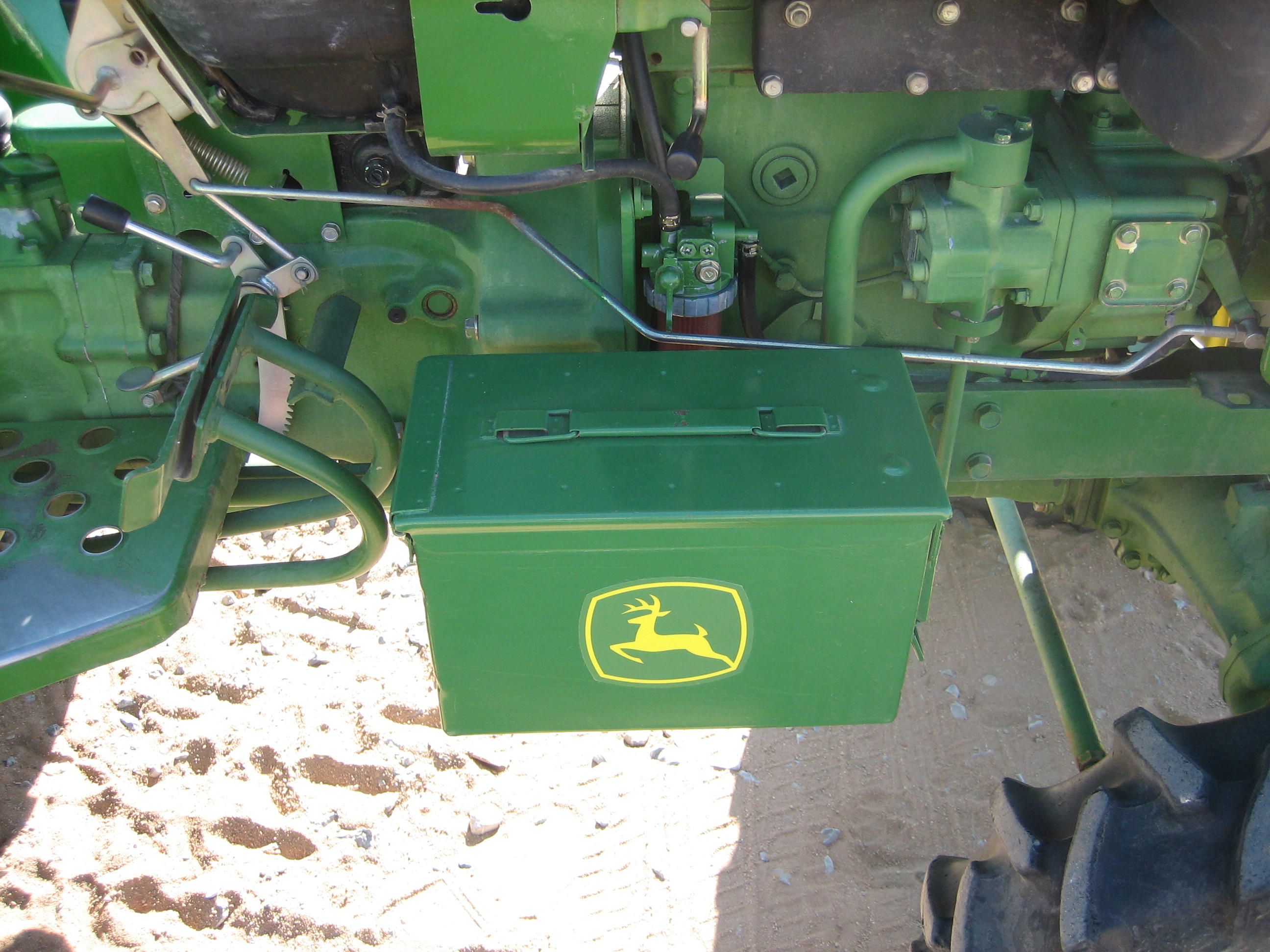

Mine is green :D
