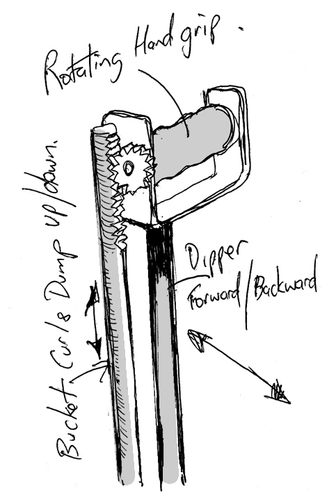

My sketch attached shows an idea for a backhoe dipper/bucket control that uses a rotating handgrip to control the bucket instead of a left/right lever movement. Something like this would seem fairly intuitive to me, as the bucket would mimic the rotation of the hand.
Theres no great engineering required here. The rotating handgrip simply pulls the valve up and down, just the same as the existing lever does.
This idea seems so simple there must be something wrong with it. Has it already been tried and rejected?
An even simpler design would use a short lever on the end of the hand grip instead the gear arrangement. It would depend on how much force is required to pull the bucket lever up and down.

I finally got some coordination with the existing levers and you come out with a better idea.
My problem with you design really relates to having to use that much strictly wrist motion while operating the bucket. My wrists are bad enough from mousing on the computer too much, I don't think they would like this arrangement.

I'd be willing to try it. Perhaps it is the wrist issue that makes this not exist though, but who knows. I like the sketch. :)

It is a good idea, but they would have to offer the regular or this way as an option because of people with hand and wrist disabilities. :)

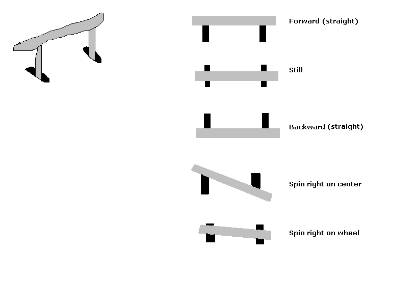

Here is something that I've wondered, similarly. Those ZTR mowers have two big sticks that you use to control them. Why? It seems like a waste of a hand if you need both. I'd like to see something like this crude drawing I did that could be held with just one hand. (This assumes that a true zero-point turn is a capability of the machine. I'd really like a dozer with this type of control actually, since I'm not a ZTR guy.)

As you move the lever you will also be rolling the wrist control unless you roll your wrist with the lever...which might be harder than it sounds
