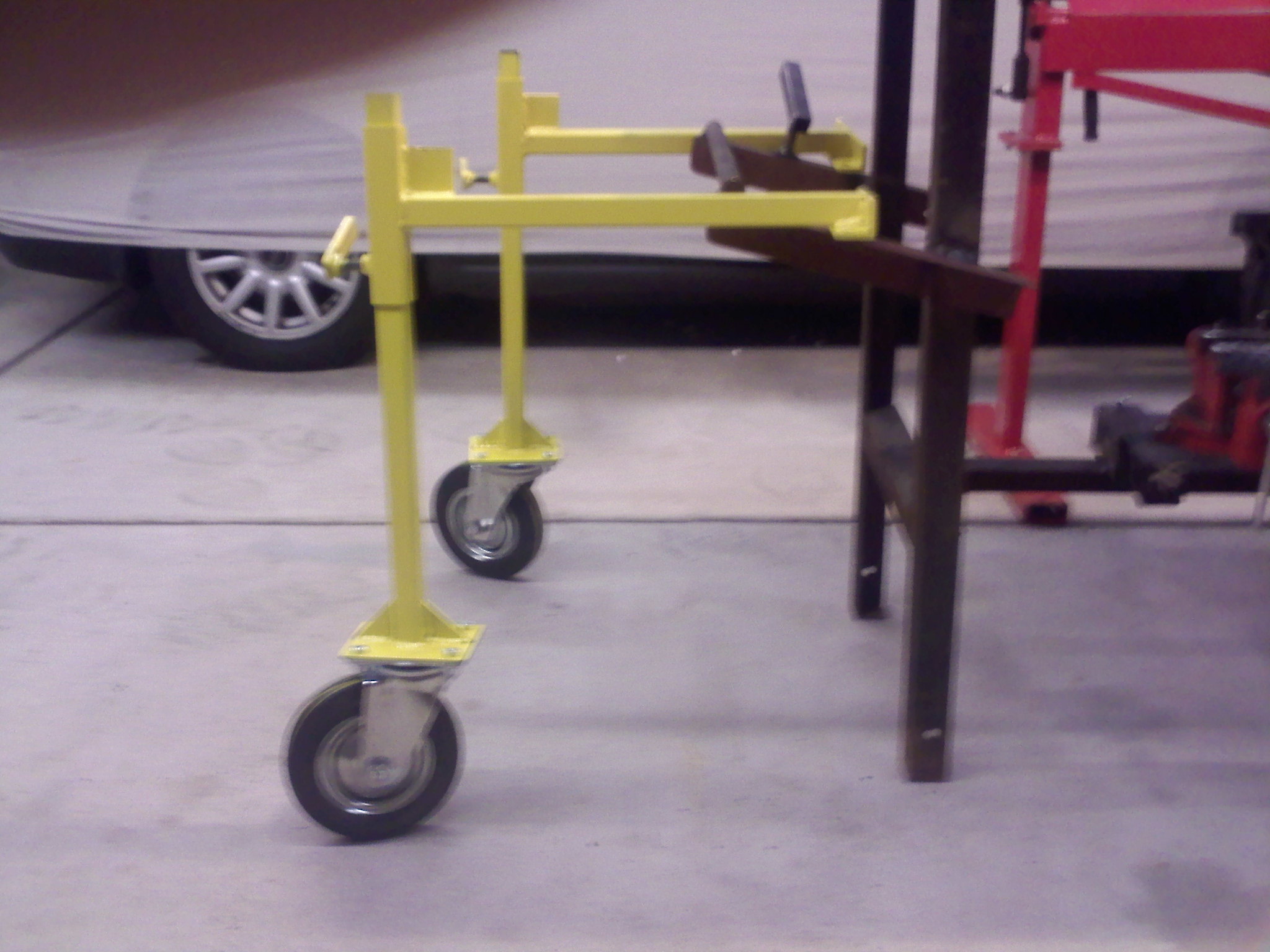

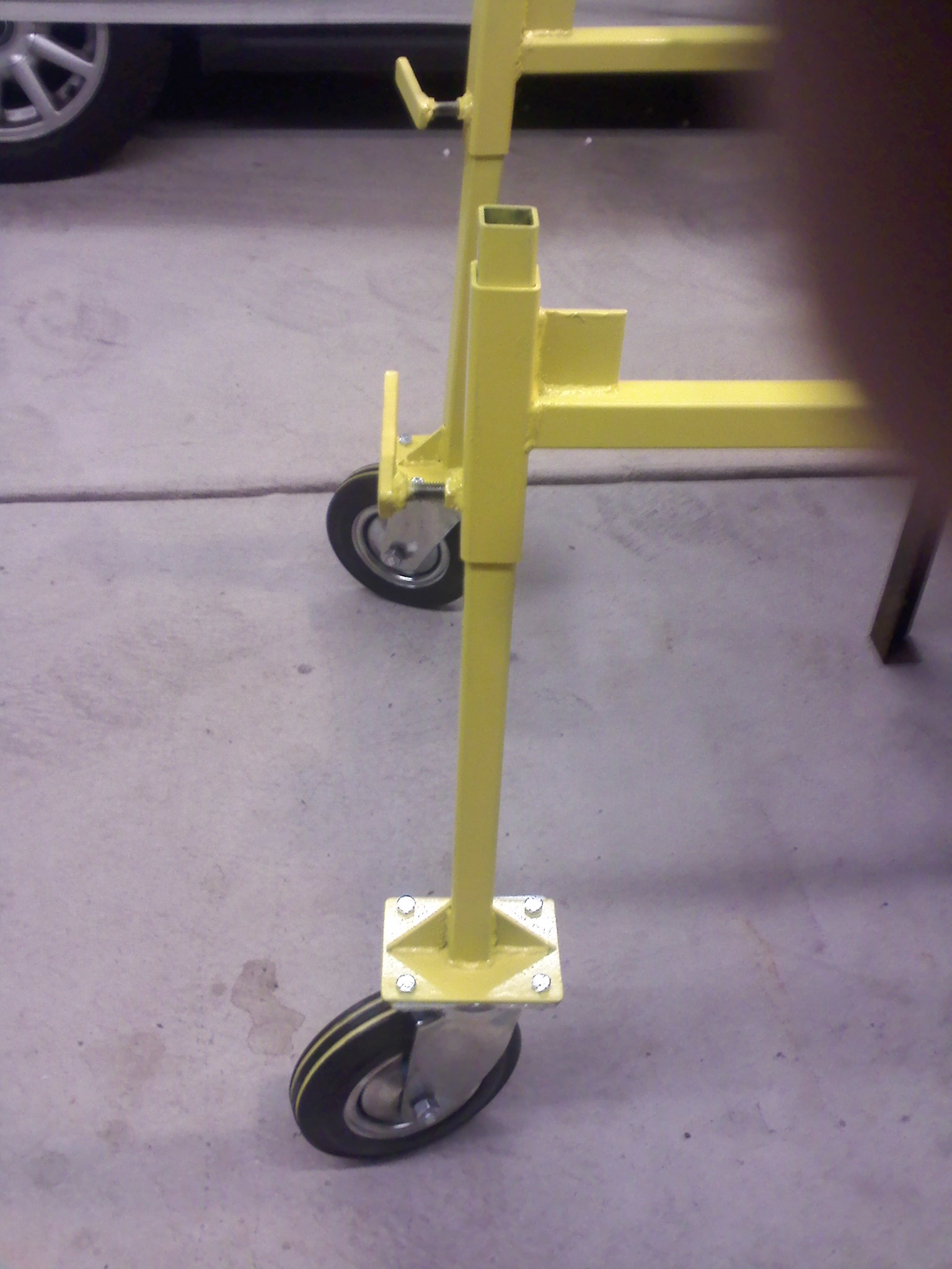

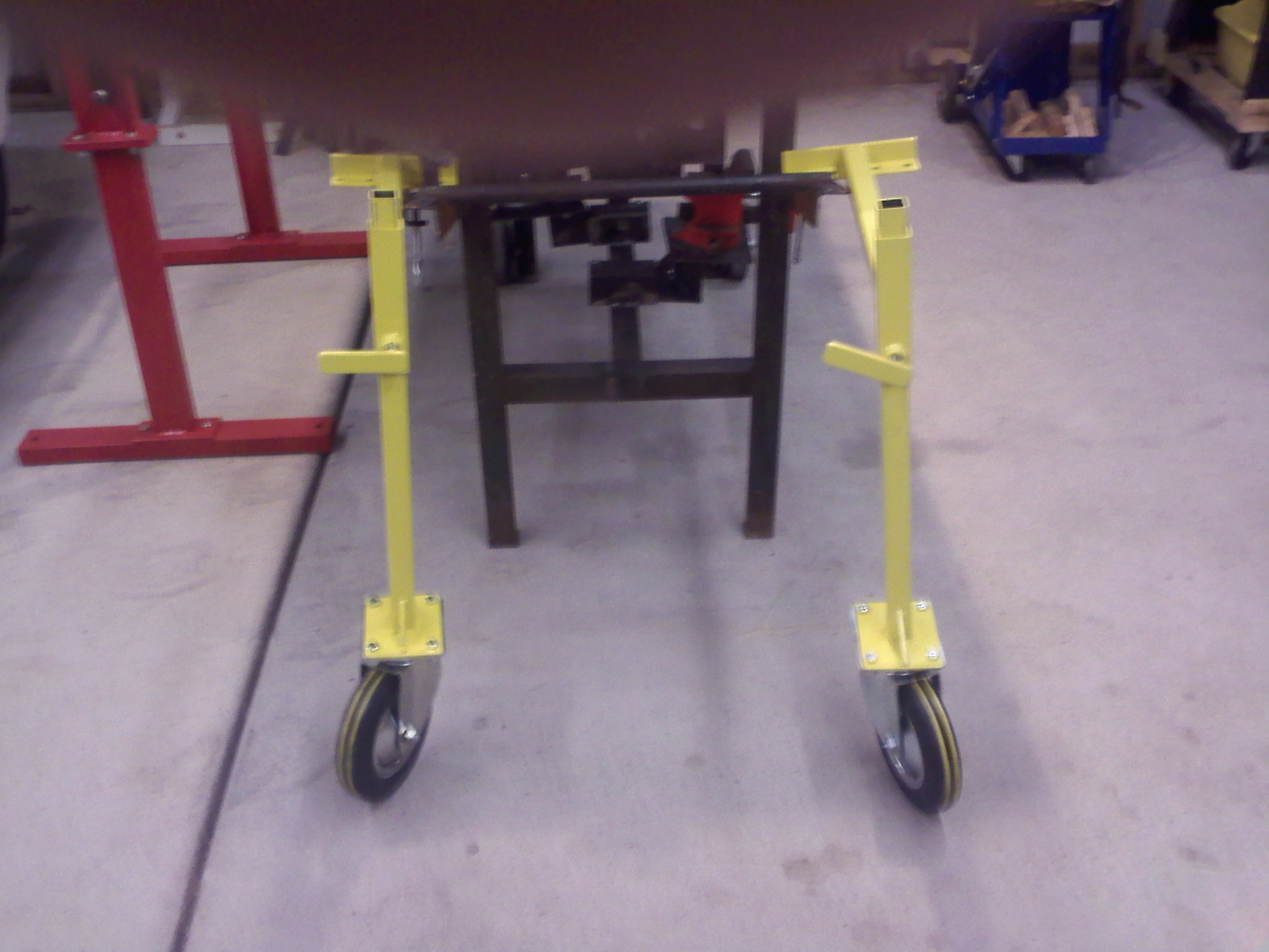

I did a progress report (pictures) in customization section. But this are the final pictures. Now when the mud dries up and I can get to the rake I can install them. I extended them 18" from the tine bolts and the length of the leg is 24" plus the 8" wheel that should give me plenty of adjustment. The wheels I used are from HarborFreight (item #46818 swivel caster). They are hard rubber and a zerk fitting on the axel. Got them for $11.99 with coupon. Total spent I would say around $40.00. I think they should work pretty good. Thanks for looking.

Nice work JJ! :thumbsup:
Let me know how those hard tires do.
   / And There Done, Guage wheels #4
Depending on how rugged your terrain is, ups, downs, bumps, etc. how do you think hollow box stock tubing vs. solid bar stock for the arms will work out? Looking forward to the working photos. Good job!
   / And There Done, Guage wheels #5
Have you given any thought to coming up with a way of keeping dust out of the ball-beaings that allow the caster to swivel. If not, you may give some thought to using some silicone caulk on the joint (but obviously keep it from getting into the bearings) as sort of a bearing seal. To make sure it doesn't tear, wipe one surface with a little grease or oil first (extremely lightly, so only a film remains) and then create a covering of the joint with the caulk. I'm afraid unless you've done something, that bearing area will quickly be shot.
