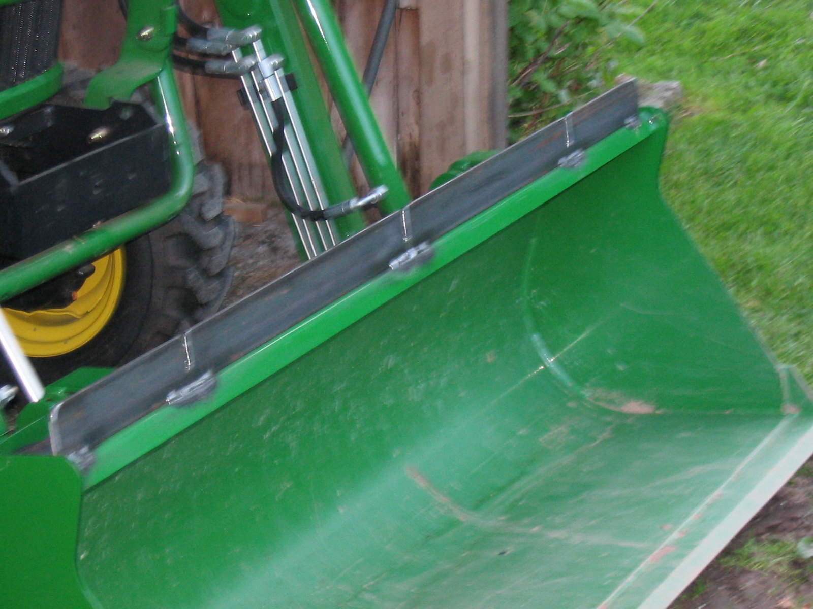

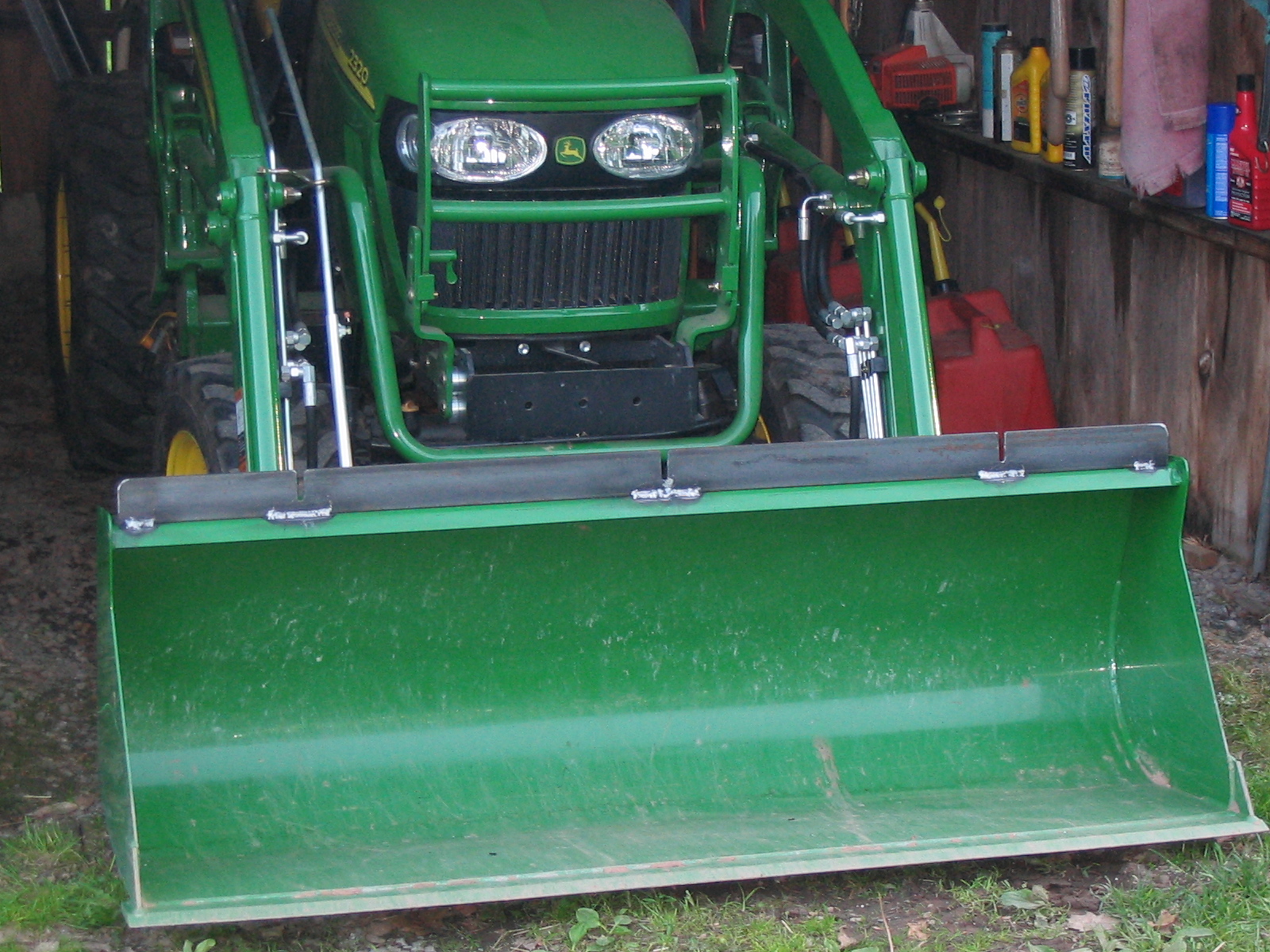

All that's left is the painting. Had this setup on my 650, worked very well. Makes for a stronger bucket also.

I made one similar, bolted on instead of weld, for my last tractor except I also welded 1/2" coupling nuts on the inside corner of the angle at both ends and two more pointing up about three feet apart. Screwed in bolts that had slightly more than 1" of smooth shank and used them for picking up stuff with 1" nylon slings. Some things don't like being picked up with a chain.
I kept it when I sold the old tractor but haven't managed to get it on the new one yet. I do miss it on occasion. It will need a bit of modification because the bucket is different.

Nice job Gizmo and good thinking.
That addition should work well for all kinds of things and strengthen your bucket top, like you say. I don't know what your fel lift capacity is, but I imagine the angle iron will be strong enough to exceed what the lift capacity is (I assume).
I would watch pulling stuff with it though, as that might exceed ... don't know.

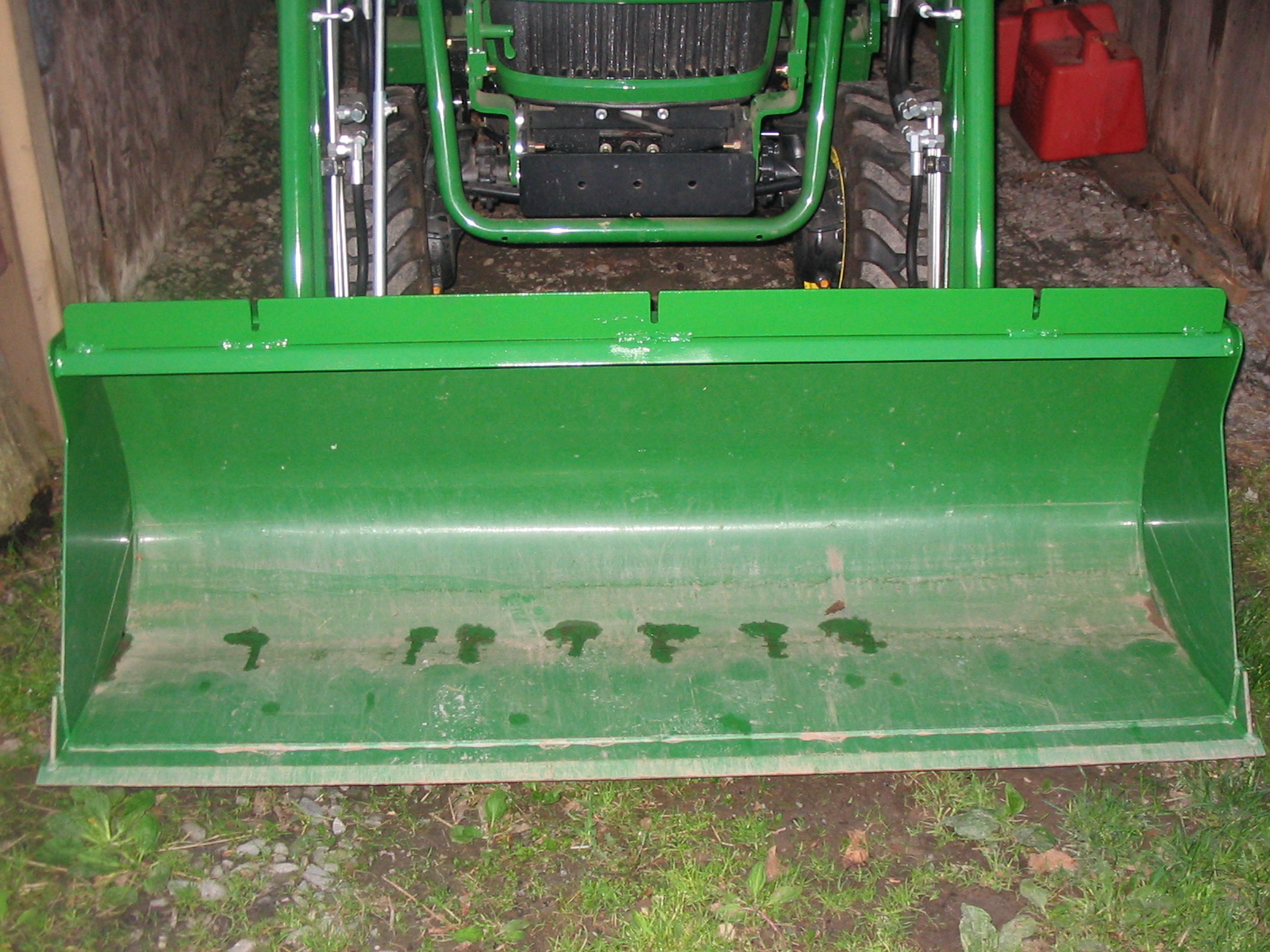

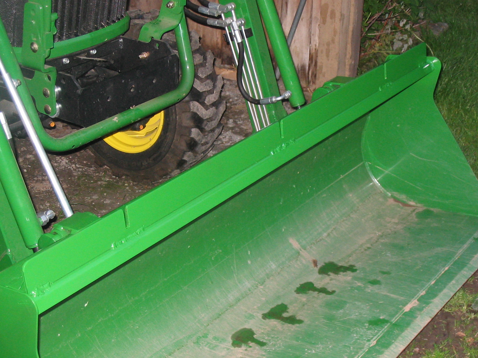

Done! Thanks for all the nice comments.

That is about as clean and simple as it gets!

Looks great! Did you put some reinforcing ribs on the back side of the angle to tie the two legs together? That would really beef it up. I also like that you took the extra time to round the corners off the angle. Your body will thank you for that if your are walking by the bucket and slip or cut the corner too quick. It gives the bucket hooks a finished appearance.
I made something similar as my first welding project; but I chose to bolt mine on the bucket.
