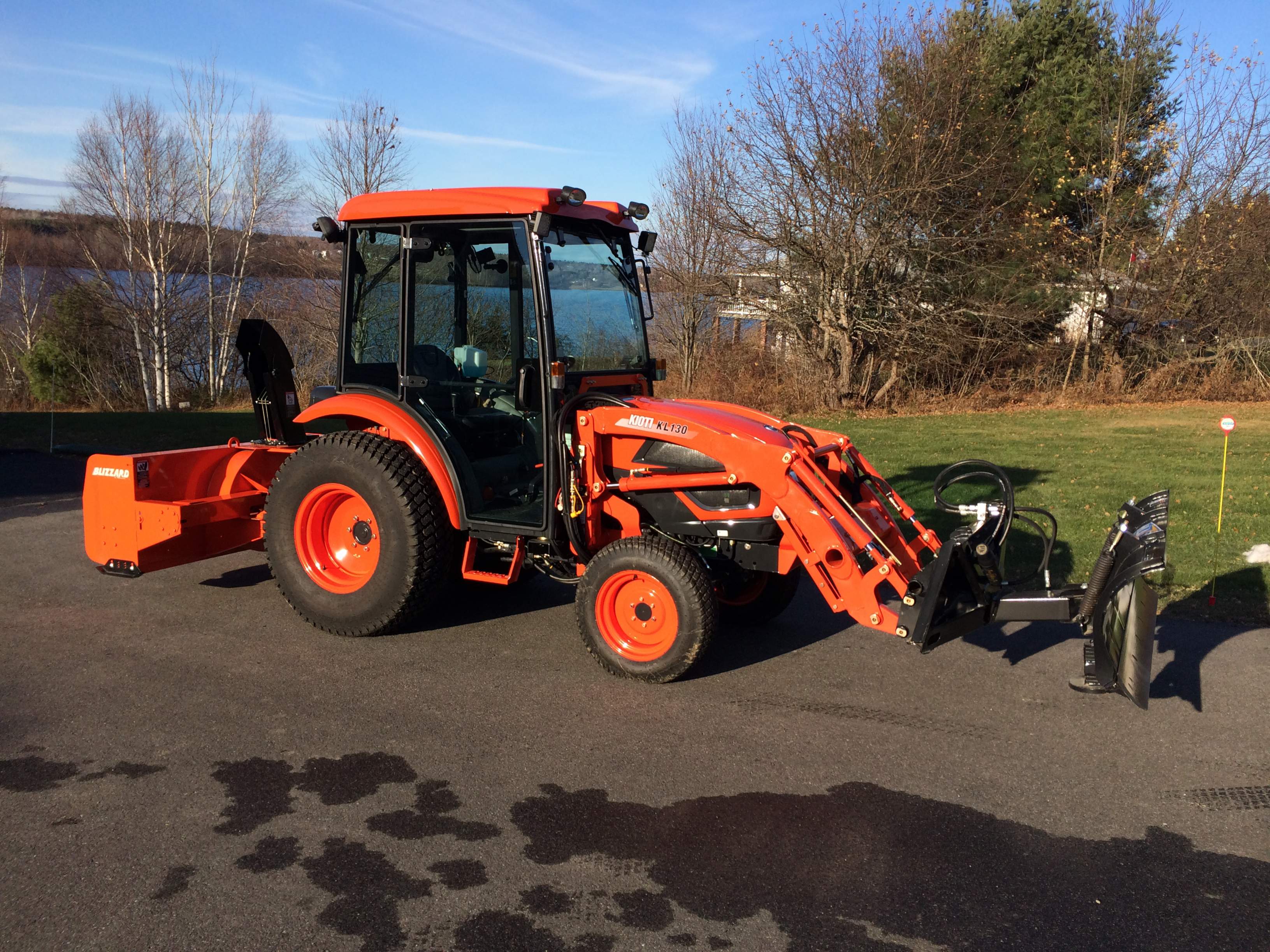

This is my first year plowing with the CK35, but I'm very pleased so far. The first snow was about 10 - 12 inch of heavy wet snow. 2nd plow was about 4 inch of wet slush, again no problems. The CK never spun a wheel, never missed a beat, didn't move sideways at ALL. With that said, every tractor, every plow truck at some point will veer sideways if pushing enough snow. With a tractor your size, it's not going to happen very often.
For comparisons, my CK35 weighs 5000lb with Plow and Blower, I run turf tires, non loaded year round. 001.jpg
