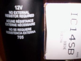

and here's the proof on that napa ic14sb
pic quality is poor.. but you can read exactly what it says!
i wish that 'internal resitor' rumor would quit being propogated and go away! :)

" I wish that 'internal resitor' rumor would quit being propogated and go away!" ....Dang..I got sucked up in that vortex on the stovebolt forum. I stand corrected. That is the coil I have.. I'm throwing in the towel on this too!!!! Ha!
sorry.. not trying to be abrasive or anything.. .. I've worked on literally hundreds of old tractors ( even own a few myself ;) ) and I just get a lil nervous eye twitch when i here someone telling someone about their internal resistor coil... all those years of engineering school probably don't help the situation either. ;)
