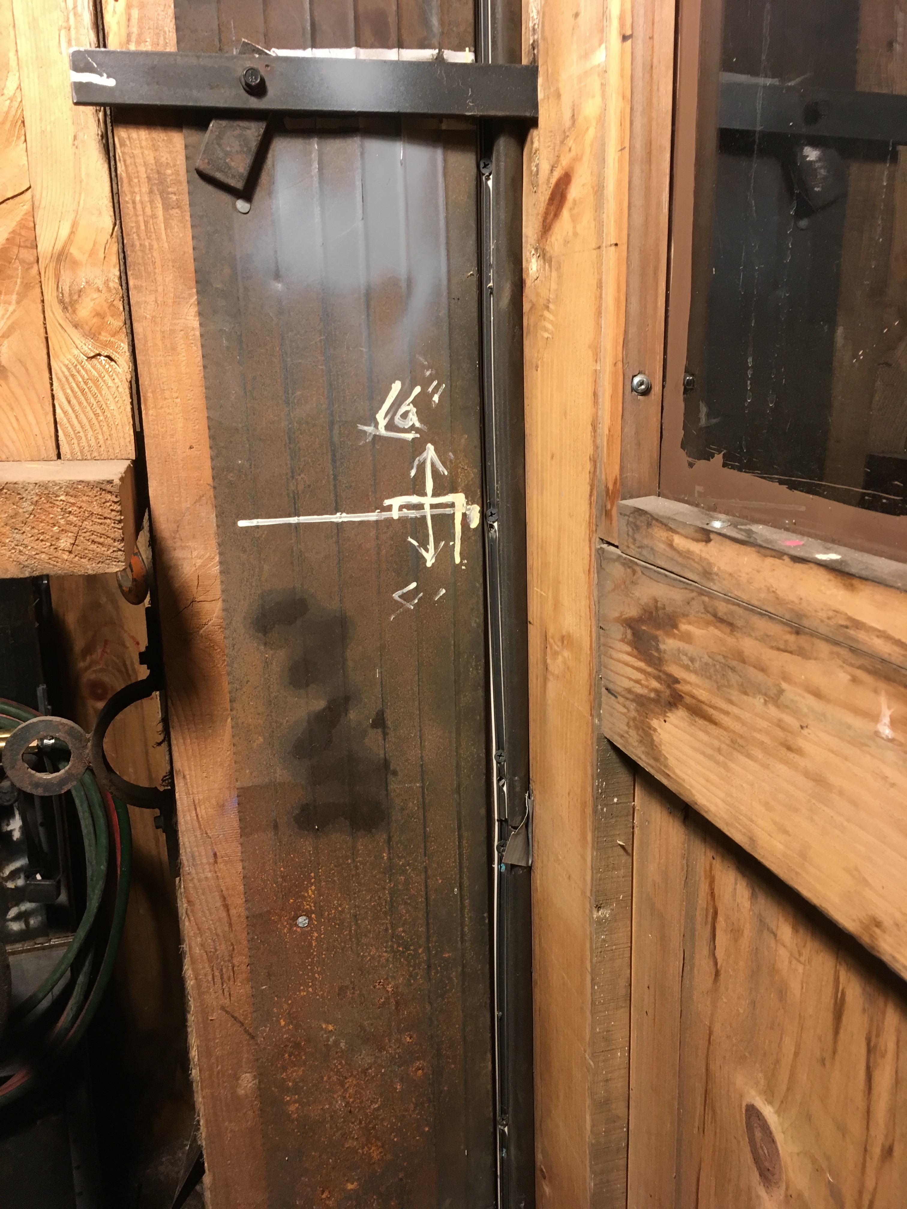

The 3rd picture is a cam thing that holds the door in at the bottom. Sliding barn doors was a challenge for to find something that would seal the gap, these seem to work the best for me, I got them at HD a few years ago. The white piece is screwed on the top across the door opening and was easiest one to put on, I wanted brown but that color was sold out. The other vinyl clad seal came in 3' sections, wish they came in 8' sections. I used sheetrock screws to hold them around the door opening and some duct tape on the joints. I find hard to find some sort of sealant that can be screwed, nailed or stapled that will squish down to almost nothing, self adhesive stuff dont hold.
