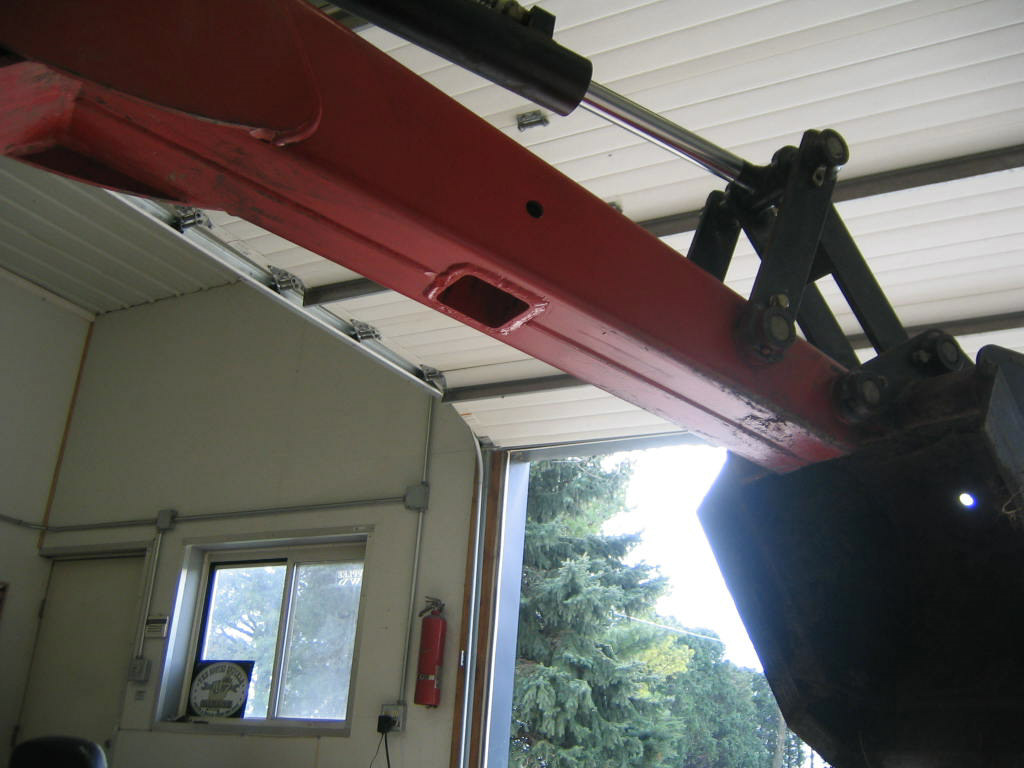

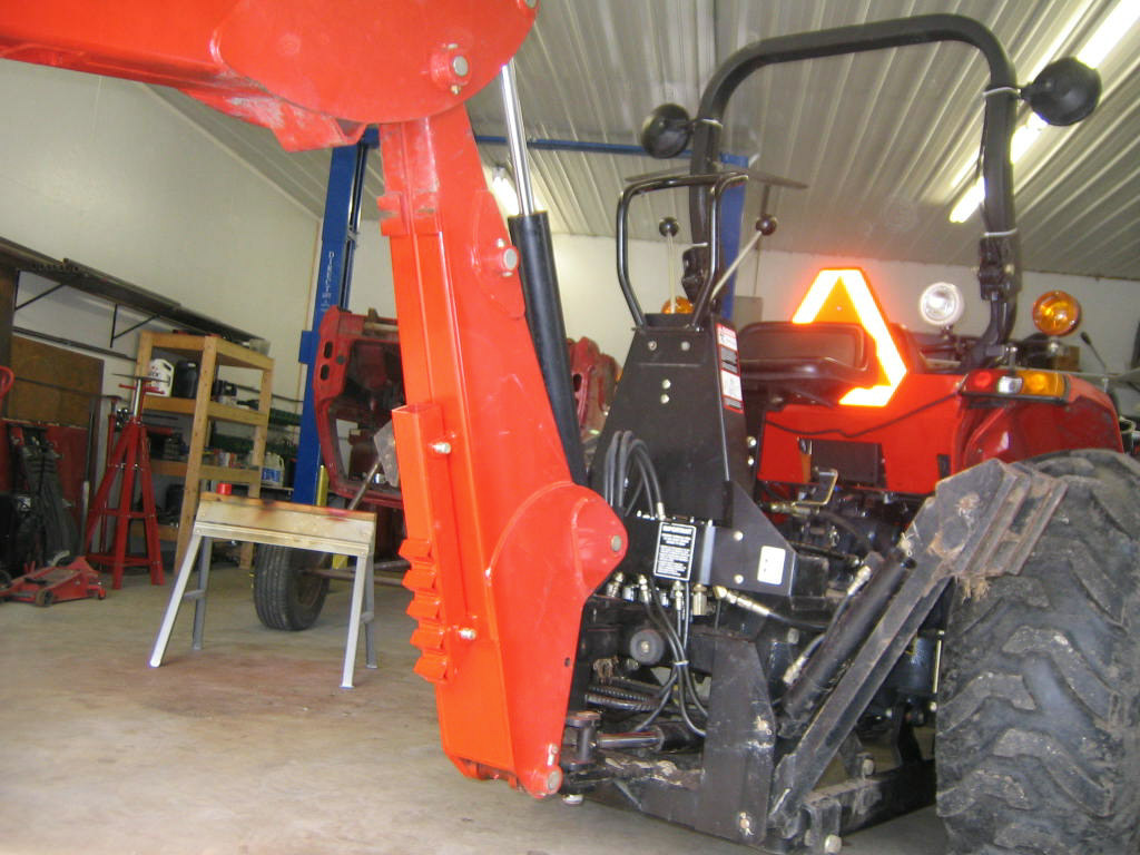

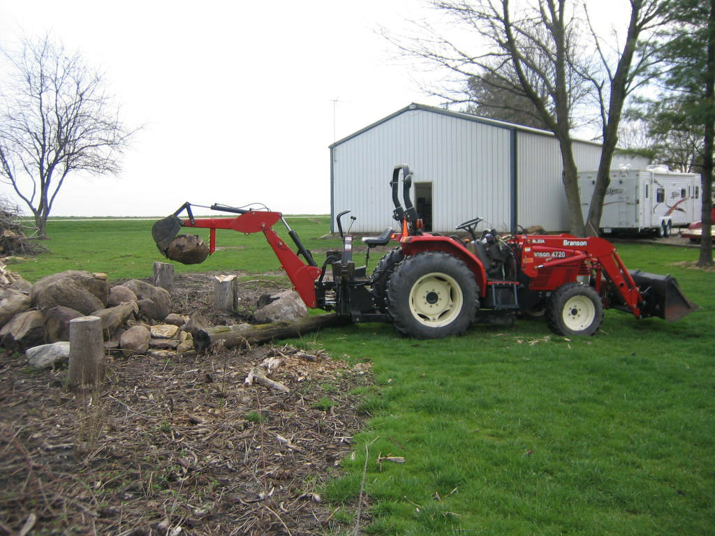

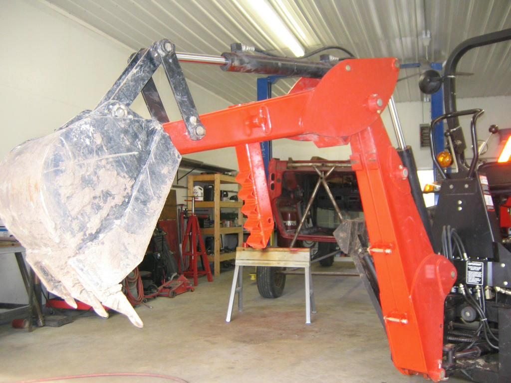

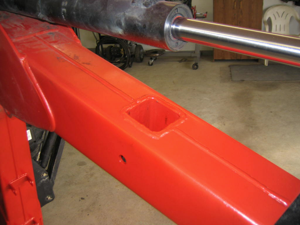

Simple and cheap.
I welded a (1/4in wall) sleeve inside the stick for strength, IMO it's as strong
or stronger than it was....
I like my storage place also, it doubles as a 2nd pinch point, which I've
used many times in the past without the thumb there.
I think it will serve me well.
I made this out of scrap metal that I had laying around.
Total cost about $10 for paint and pins ;)
Gene

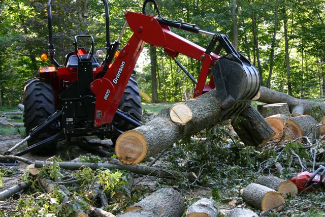

Nice job Jeb! I built a traditional one, here it is. You will notice it is the same machine!
