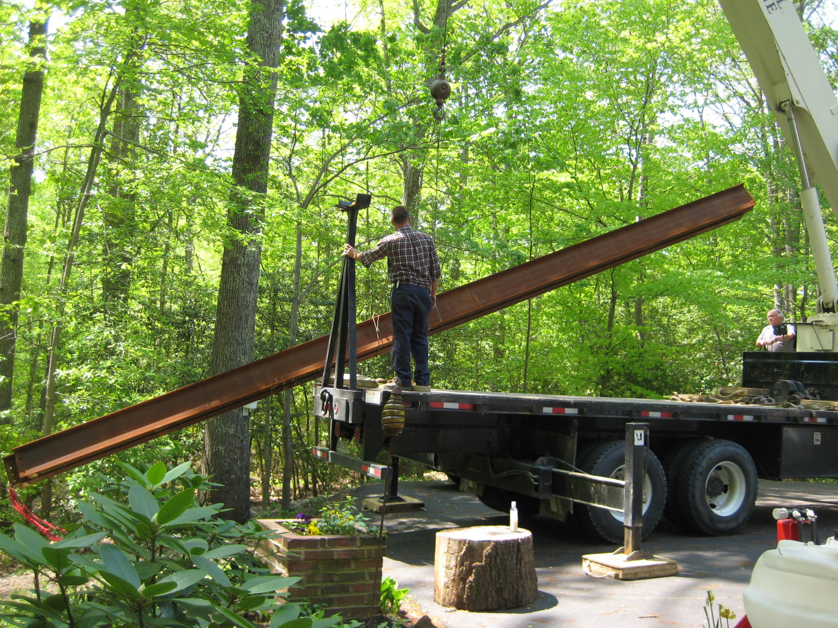

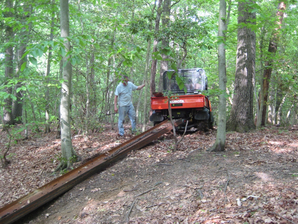

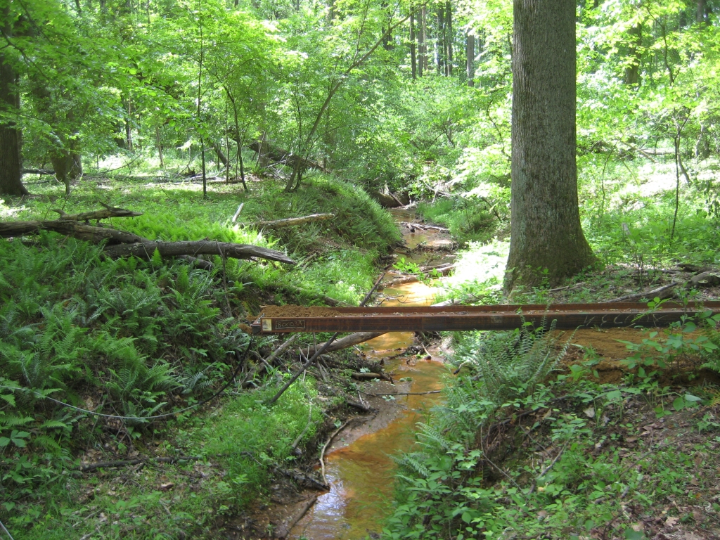

OK, time to open up another 20 acres or so of land. We've saved this for last since to get to it I needed to span about 26 feet of creek. The last bridge spanned 24 feet, so I was comfortable using 2x12's spliced together for the beams, spaced 20 inches apart.

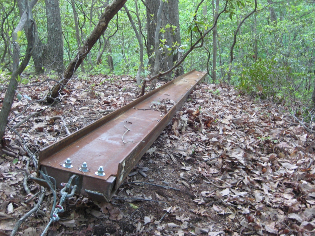

The beams to do this needed to be at least 28 feet, and that was going to easily be $600 in wood and bolts. Lucky for me, a local steel erector had two 30' long W14x22 beams. They delivered and unloaded them for 600 bucks, so I was in business.

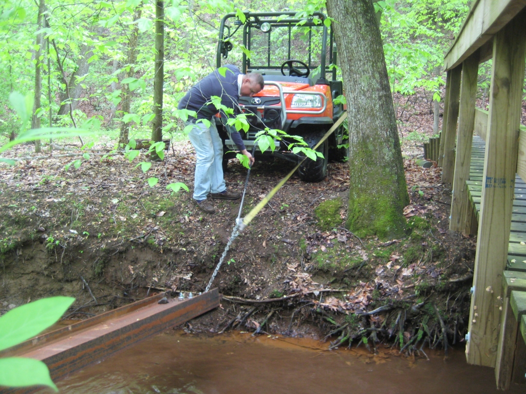

The next part of the project was to move them over the existing paths about a half mile through the woods and existing trails.

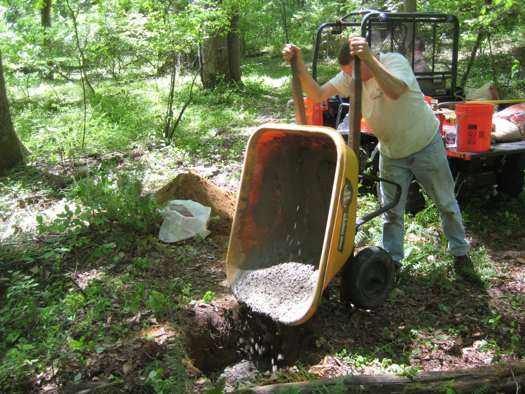

After getting the steel close to where I wanted it, I told my wife to dig the footings and poor concrete. In addition to my arms being sore from mixing concrete in the woods, my butts sore now too... Each footing is 2'x2'.

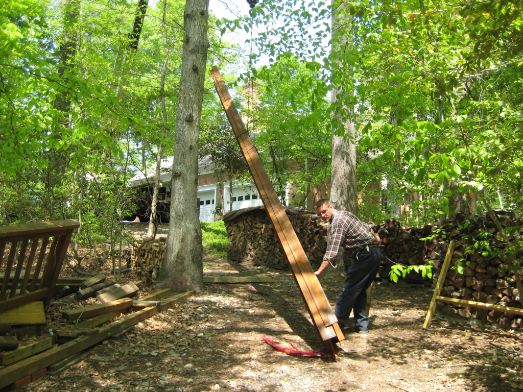

More pulley and winch work and the beams are both in place.

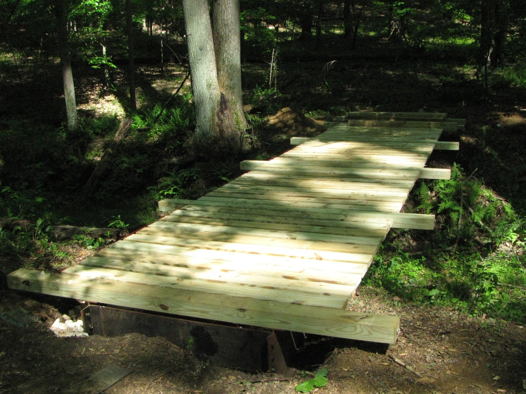

This weekend I'll start putting the deck down. Sorry for all the pics at once!

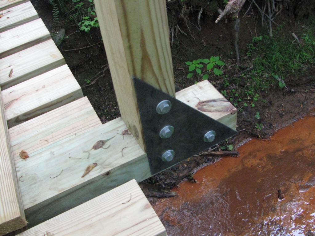

Wow!!! That is crazy. These were scrap, I think they may have been tweaked slightly, but not too much. I did look at using an old trailer frame from a semi, almost bought it. This is more work, but I think it will be better in the long run.
This weekend I am putting 2x6 lumber over each beam so I can start putting the decking down. I'll bolt the 2x6's to the beam, then run the deck on them. Pics will tell the story.
