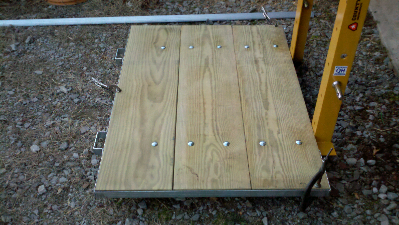

The start of the base

So far, so good.
I used 2x12's also for my floor and front side.
Looks like you're going to have side and back boards on it?
   / Another carry all project
I am going to add sides and a back as needed. It was taking longer since I added the angle along the edge.
Problem! Not enough clearance to hook up arms after I skinned the back. I am going to weld on and extension now I guess. I would also make it wider. Mine is 4'
   / Another carry all project #5
Do you have anymore photos? Are those 2x12s?
   / Another carry all project #6
just a suggestion...seal the ends of the boards with liquified paraffin before setting them in angle iron...the angle will tend to hold moisture and cause premature decay of the board ends...
For anyone that may not be familiar with working with wood for outdoor use...always apply the "bark edge" to the weather...looking at the end grain will reveal the outside (bark edge) of the tree

Will most hardware stores carry this (liquified paraffin) or Lowes,tractor supply?

yes 2x12. I will post more soon. I have done some more but very little. Both my boys wrestle and now baseball. The time change got me working on it yesterday. I will post more in the next few days. Thanks for looking.

you can get paraffin in most grocery stores...look where they have gelatin or canning supplies...
I usually use a torch and coffee can to liquify the wax...then brush it on with a disposable/reusable brush...
you can just shave off some paraffin and with your boards standing on end use a torch to melt the wax into the endgrain...
If you notice when you're in the lumber yard all the ends of new boards will have a thin wax coating...this is done after they are kiln dried so they do not absorb moisture...
   / Another carry all project #10
/Pine - Sealing the end grain of the wood is a good idea. Also, bark side out keeps the board from cupping and holding water.
Some background on this:
I do some wood turning and need to let the wood dry evenly before turning to prevent warping and splitting after it is turned. The end grain lets out moisture in the wood faster than the side grain, so we try to keep the moisture evaporation even to prevent splitting, etc.
When the wood is dry you want to do the opposite, that is, keep moisture from being sucked into the end grain. What I do to the end grain of the wood is dip about a half inch of the wood into an old electric fry pan about half full of old candle stubs. I heat the candle wax to about 250 to 300 degrees. I do this outside. When the wax is all melted and almost smoking, I dip the wood in about a half inch. I hold it there a while until it starts to bubble or hiss. This insures that the wax has been sucked into the capillaries of the end grain. As the wood dries I can see the wax squeezed out of the shrinking end grain and this tells me that the wax has penetrated the wood and it will keep out the moisture.
Be careful of the hot wax. If it get too hot it can flash into flames, that's why I do it outside.
I have tried to brush hot wax onto the wood and found the the cool wood just holds the wax onto the surface and if hit or rubbed, the wax just falls off. That's where holding the wood in the hot wax heats up the wood and the wax and wood sort of "fuse" together to make a good moisture barrier.
HTH
Clem
