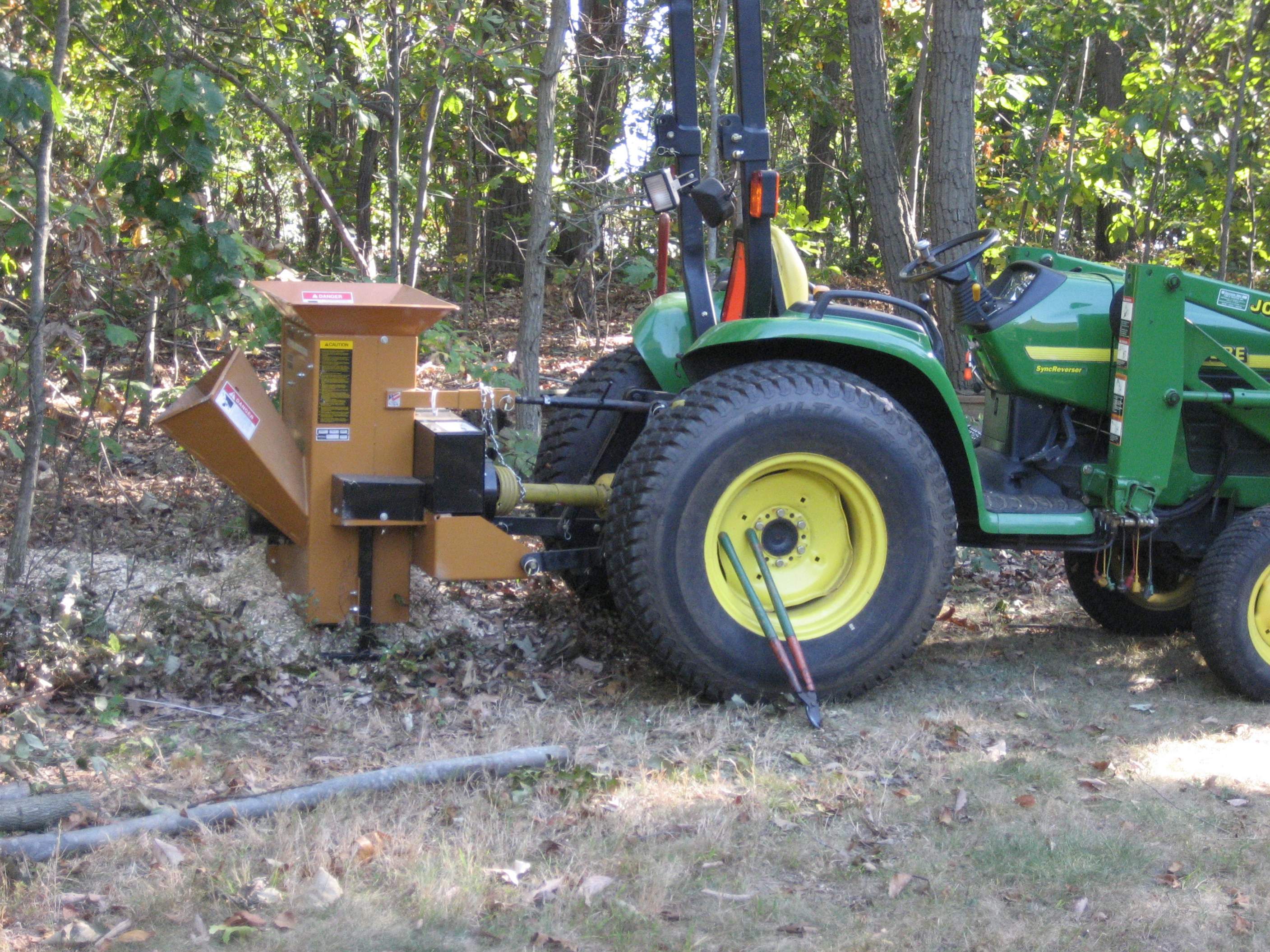

I've got the Woods 5000 Chipper/Shredder with a chipper capacity of 5" material. And, as nspec wrote, they're made by Bearcat. The equivalent to my Woods is the Bearcat SC5540.
Nice chipper/shredder!! The only downside is they don't have a blower chute (but it is an option) and the chips fall under the unit.
BTW, 25 PTO HP is perfect for the SC5540 (or Woods 5000).
So, I suggest you determine your future needs to decide to rent or buy. If you do buy, definitely give those Bearcats a good look. They aren't the cheapest, but they'll last you years.

That's the same unit I have. I looked into purchasing the optional blower and was worried about it robbing power from the chipper. Also, I had read a lot of posts about this particular blower/chute being prone to plugging up. Yes, the bottom discharge takes some getting used to, and you may not like it. I have gotten used to it and don't mind. I prefer the compact machine over a big chute. Also, I've never had a plug, and the unit has had some pretty heavy use.
Yeah, the bottom discharge doesn't bother me at all.
