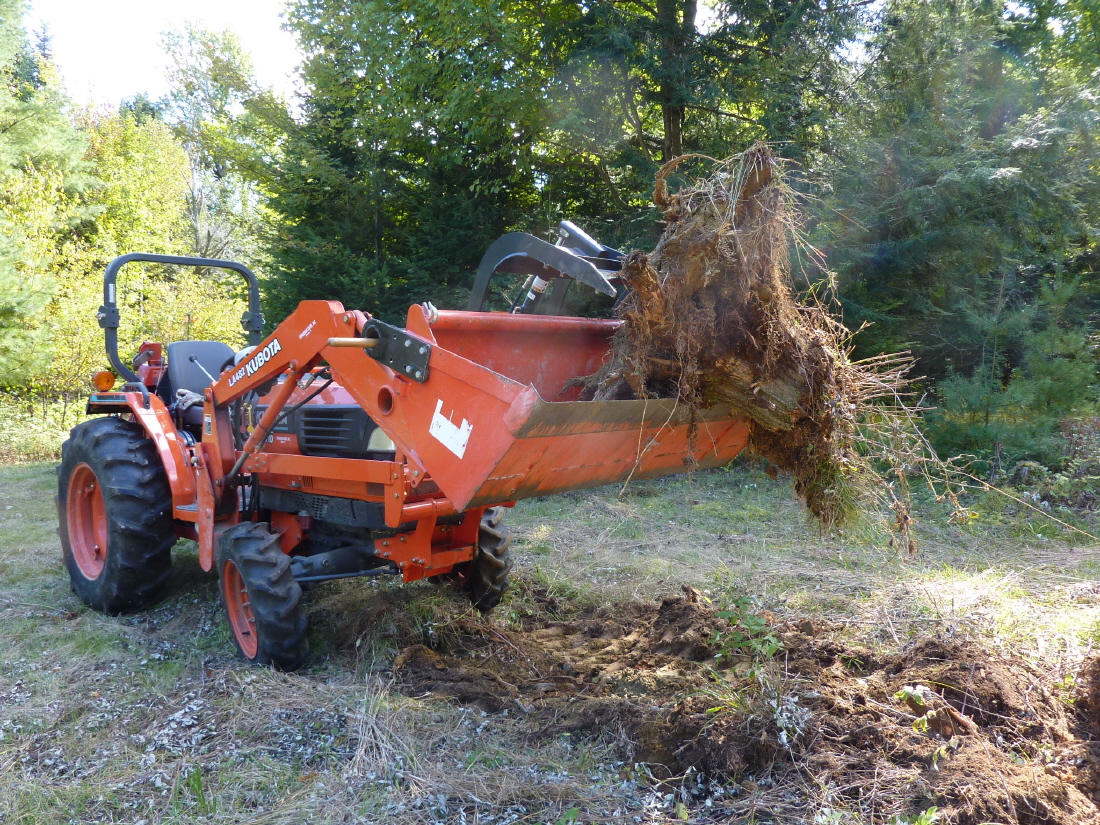

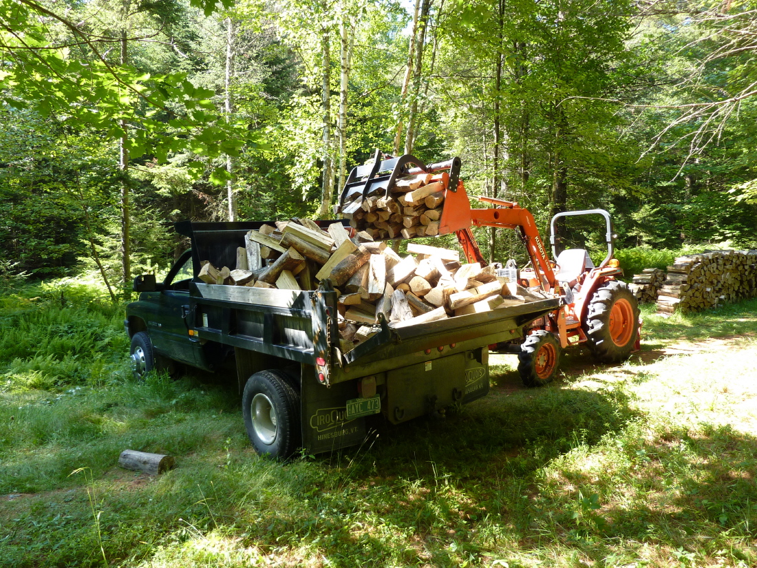

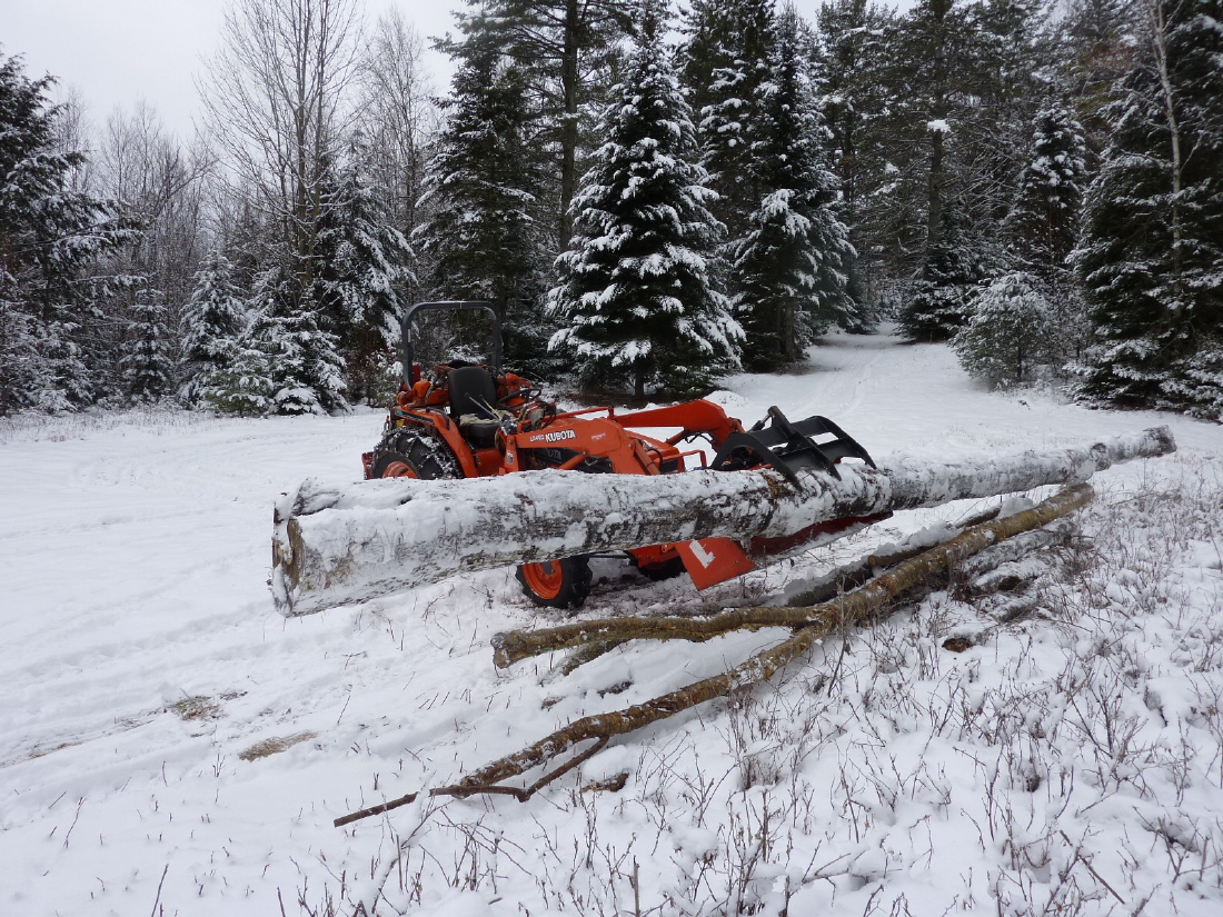

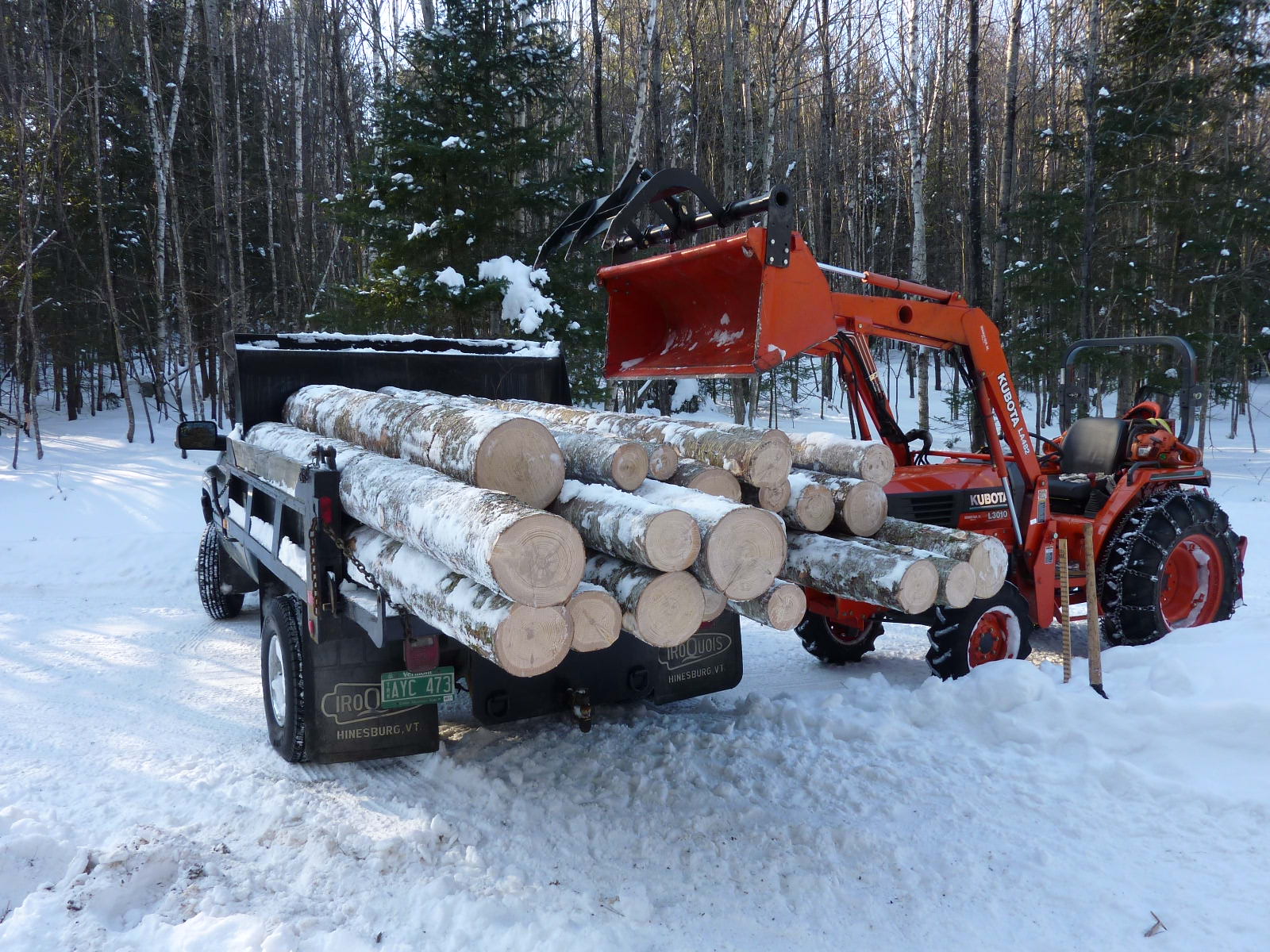

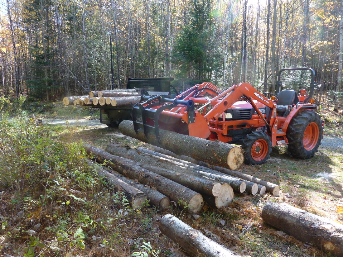

I have an ATI bolt on grapple which I am very happy with. Doesn't look mean like some grapples do but does a real good job for me. And it is there all the time w/o changing impliments. At first I had it on a rear remote. Then I wanted to use the remotes for a TnT so I added a second valve above my FEL valve for the grapple. That project is discribed in these two threads if your interested in something likre that.
http://www.tractorbynet.com/forums/hydraulics/198367-photos-third-function-valve-project.html
http://www.tractorbynet.com/forums/hydraulics/202187-finished-3rd-function-valve-project.html
Here are a few pics of my grapple in action.
