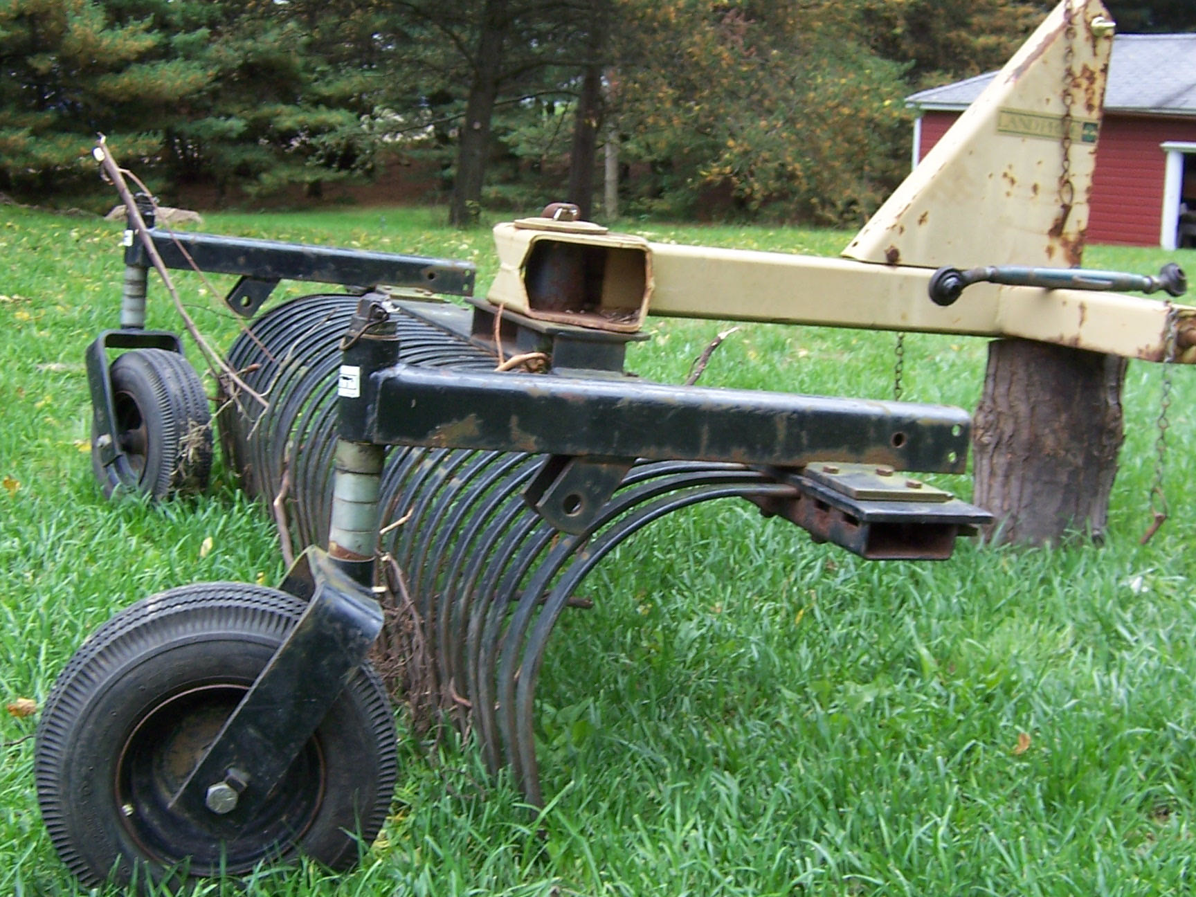

   / Another Guage wheel question #5
Attached are two pictures of the Land Pride gauge wheels. You can see the spacers that allow you to adjust them up and down. They are not as slick as HOMEBREW2's in that they don't adjust fore and aft.

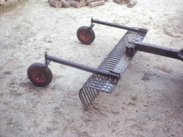

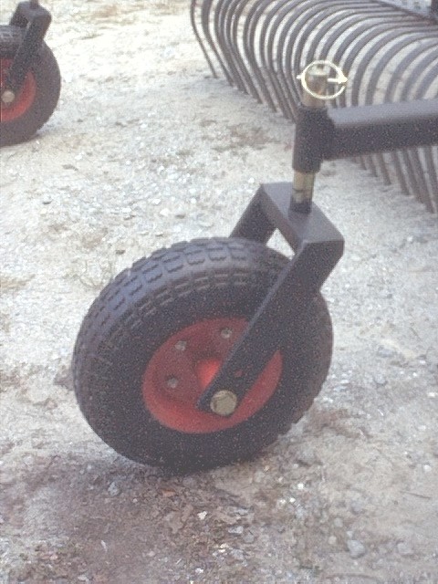

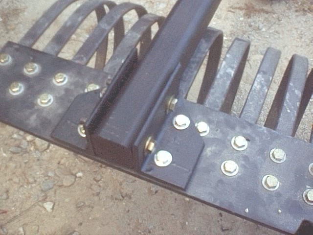

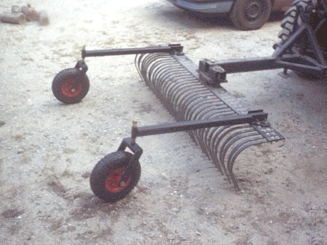

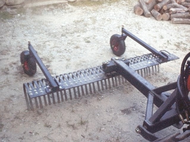

   / Another Guage wheel question #8
Here is a link to a post I made a few years ago on how I made my own landscape rake gauge wheels. The arms that the wheels are mounted on can be adjusted to any length you want from the rear of the tines. All you have to do is drill new holes. BTW, I made the rake too.
Landscape rake gauge wheel build thread

   / Another Guage wheel question #9
I'd keep the wheels as close as you can to the rake, but leave enough room so you can go backwards and the wheels will turn fully without running into the tines.
I would not think using regular casters, or trailer jacks with casters is a good long term solutions as the ball bearings on most of these setups are not sealed. They may work for a while, but over several times, I have to believe the bearings will fill with sand, dirt and small stones and become almost useless or wear/fail very prematurely. Most of the more rugged OEM and home-built designs use some type of sleeve for the caster and sealed bearings for the wheels. I do like the idea of the easy of making adjustments with the jack handling however, but I've found I rarely change the height anyway and often can accomplish such just by changing the 3-pt top-link length. (No offense intended to anyone who's gone this route however!)
