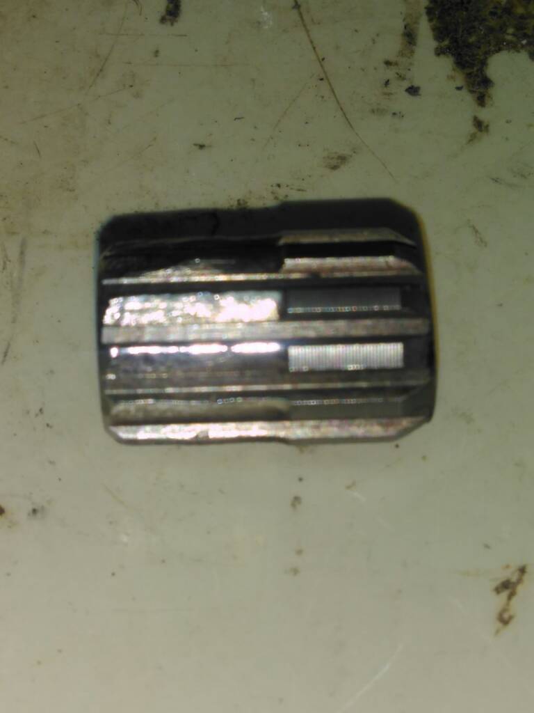

The biggest question I had was whether the grooves had been damaged which would have forced me to replace the gear in the case.
Couldn't really see inside the gear to verify the grooves due to the angle.
Solution I came up with was to cut the spline off the shaft and reversed it to check them. Happy to find that the grooves are not damaged so the gear is a much harder metal than the pump shaft and I doudt
enough moisture got in to cause other issues. Dealer has a used pump that I will get.
Needless to say this has been a learning. experience.IMG_20190419_141202.jpeg
