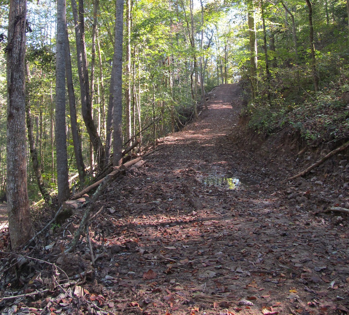

Found some older pictures. Not as good as i would like, but all I have at this time.
This is the bottom of the bad stretch, all covered in the dirt from road reclamation after logging. The ledge starts in earnest just above the puddle, and continues uphill for a couple of hundred yards. The water in the puddle seeped out of the hill up and to the right.

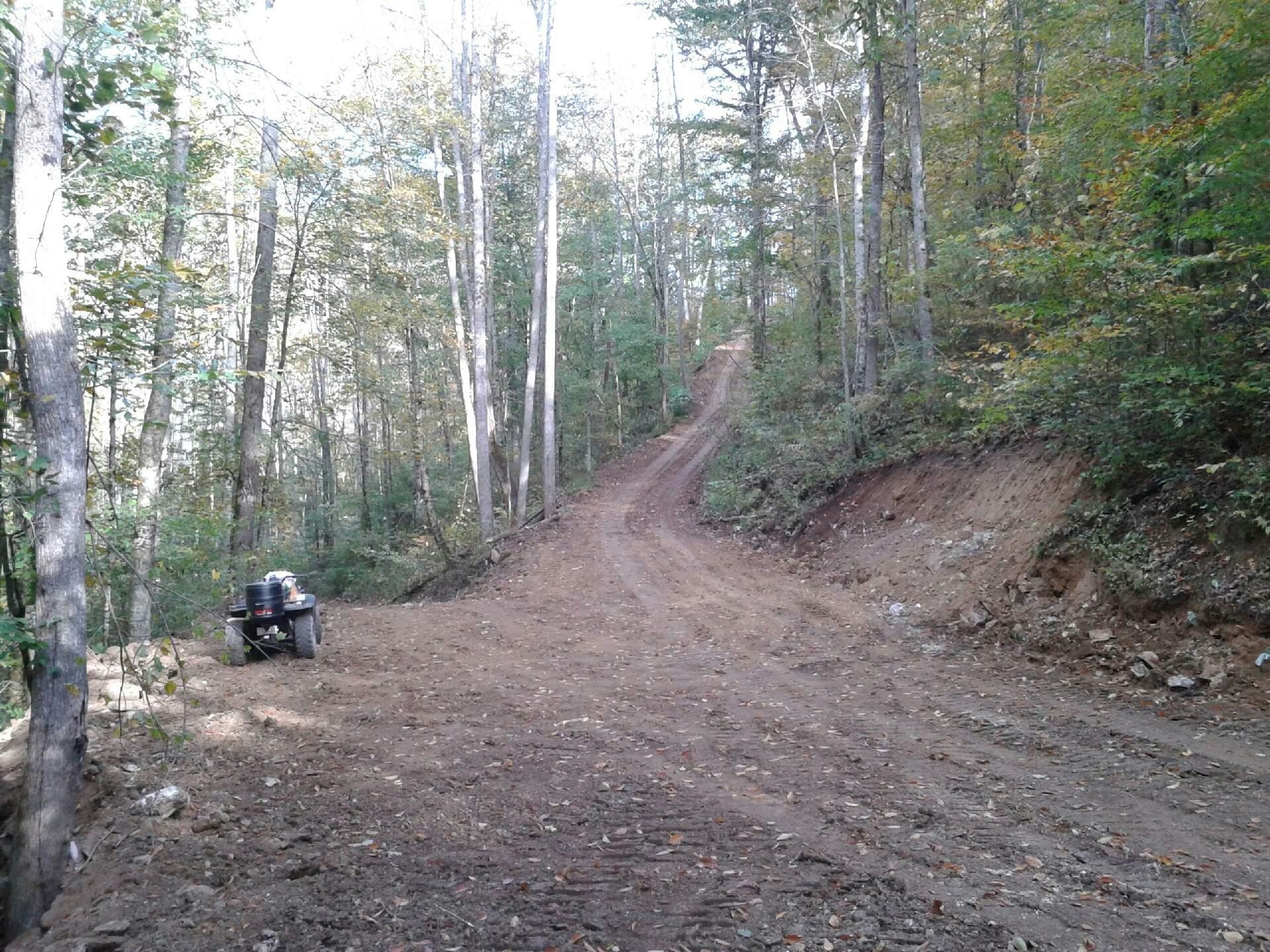

The same area after our cleanup. The road looks pretty good as there has not been time for it to get wet from the weep.
Looking at these pictures it seems that I need to cut about 5 more feet into the hillside, removing dirt and trees. Then the ledge must be cleaned in preparation for pounding the ledge. Much of this stretch has the ledge already climbing 4 or 5 feet above the road, so there will be a lot to pound. The ledge must then be pounded down, including pounding a ditch against the hillside. The crushed stone will be spread on the road..
