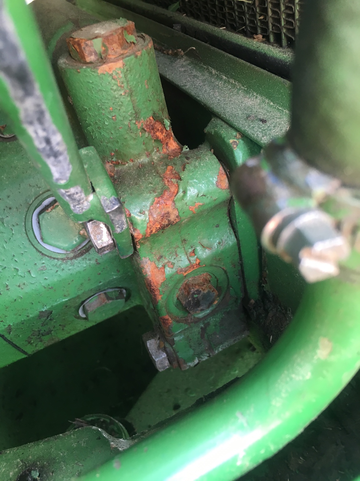

On the filter bypass valve, I pulled the plug (item #1 in the pic below), and a very slight bit of fluid came out. I didn't go beyond that though. Item #2 (threaded nipple) is pretty large and I didn't have a socket that size with me at the time. Both the threaded nipple and the plug were fully seated, so I'm not sure what an open or closed valve should look like. Perhaps it will be more obvious once I remove it?
Once I get it out I will take pictures of everything from this point on.

Here is a picture of the bypass valve. It was in the closed position upon removal.
Also - Here is the line that flows if I loosen the hose clamp. I was incorrect in my OP when I said it comes straight off the front pump, it actually comes from the rear then along the lower right hand side. Then up and into a reservoir that sits above the pump, then over to the left, then into the top of the pump.
It looks like the cap to the standby pressure test port??
I reinstalled the bypass valve and changed the filter. No change.
