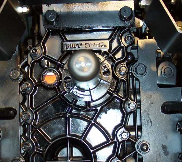

It appears that my leak may originate from two places: the bottom two bolts (of four) on the toplink plate on the back of the transaxle. I also spotted a drip that could have originated from anywhere on the top right-hand side that had formed on casting on the right of the trans oil filter.

A snapshot of the PTO and toplink plate. The two bottom bolts for the toplink plate are at the top of the picture above the "Tuff Torq" name in the casing. The fluid appears to be coming from around those two bolts and perhaps from the toplink plate gasket area.
The other area that may be a leak sorce is harder to photograph, but I will give it a shot.

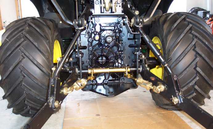

A zoomed-out view of the PTO area.

   / Another Leaking 2210 #9
Mine came with a PTO cover as you can see in the pics above. Yours should have shipped with it on from the factory.
I noticed the drop rate knob was very hard to turn as well. Interesting. /forums/images/graemlins/confused.gif After I noticed my leak, I shut everything down and tried to drop the lift arms to check the fluid level, according to the manual. The lift arms stayed locked in place even though I opened the drop-rate valve wide open. After some head scratching and checking the sight glass after it had cooled, I decided to go ahead and add some hydraulic oil. When I did, the lift arms dropped a moment after the fluid had a chance to run down into the transmission. I assume the valve was starved for fluid. I added about a quart of fluid, which didn't alarm me because I had attached a brand new front hitch for the front blade immediately prior to using the tractor, and I assume some of that quart shortage was to fill the hoses and cylinders of the front hitch.
