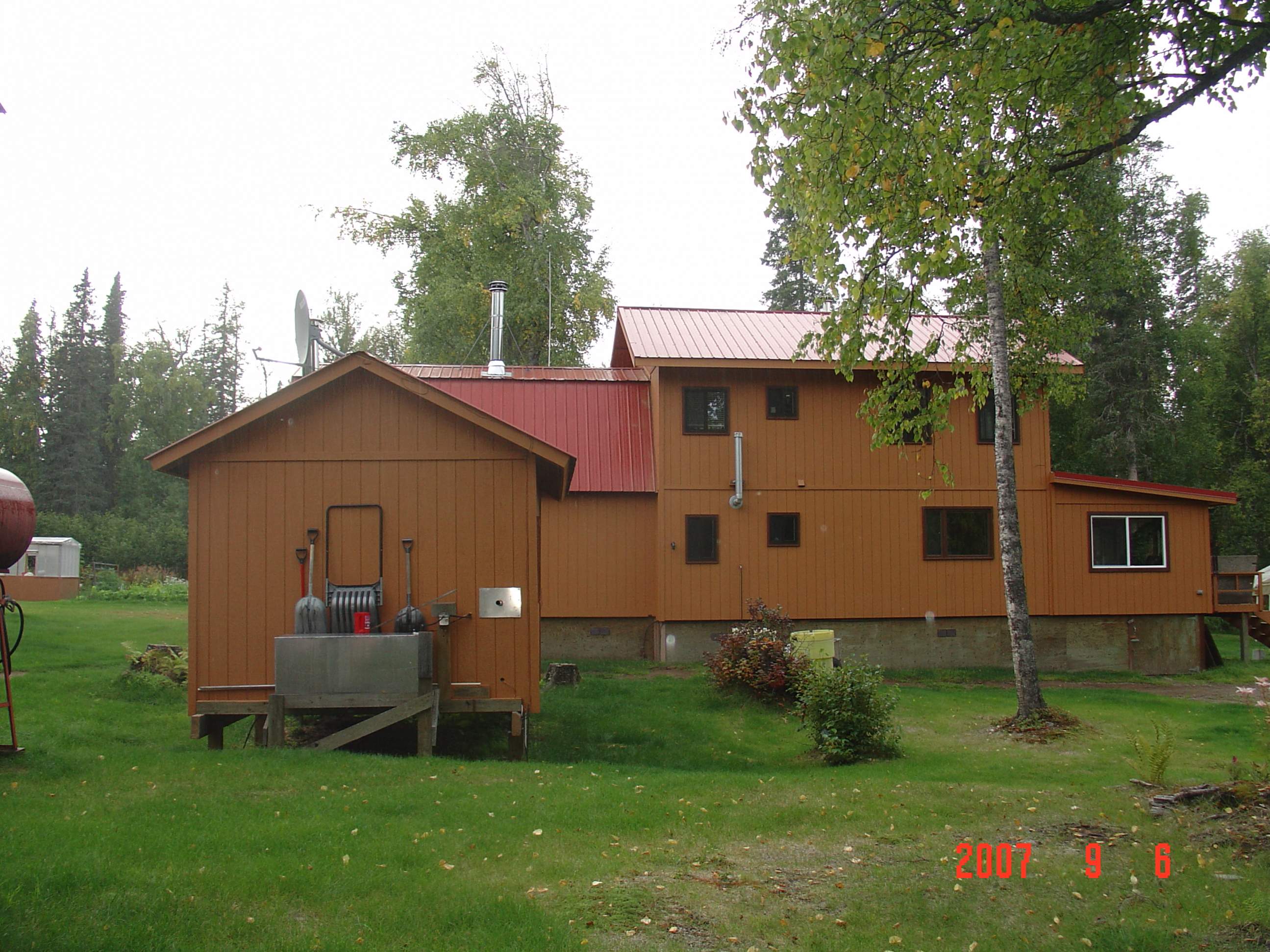

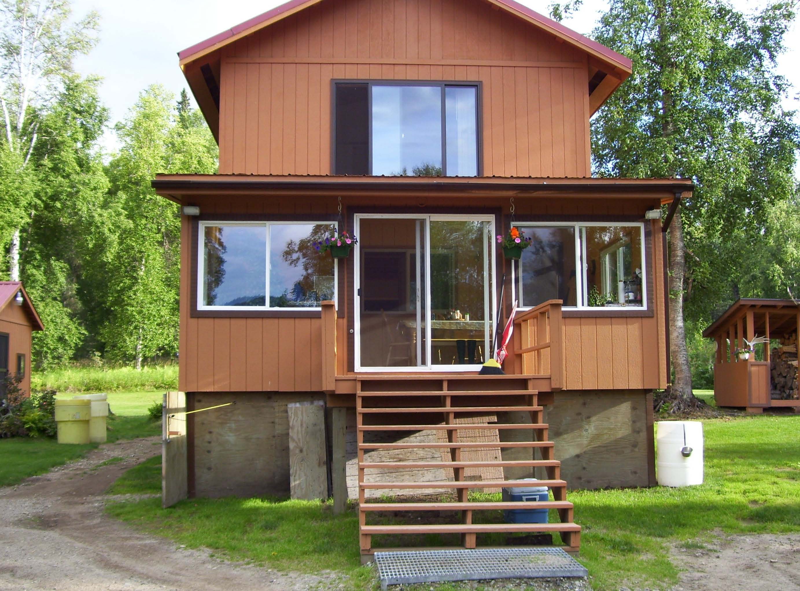

Thanks for the welcome! I think I will be on here a fair amount now I've decided to pull the trigger on a tractor. Just trying to make sure I get something that will fit my needs and have a little fun too! :D (Just a side note, I am a little surprised nobody has commented on that the size of the bear paw print my 5yo is standing in.)
Snow does get a little deep here, (it's knee deep now), but I don't plan on using a snow blower. We just park the 4-wheelers, put up the boat and use snowmachines. I've posted a couple of pictures of the house just to show you how we deal with it. I don't think the tractor would see any use in the winter; my plan would be winterize it and put it away for the season.

Great looking place you have there. Thamnks for the pictures.
