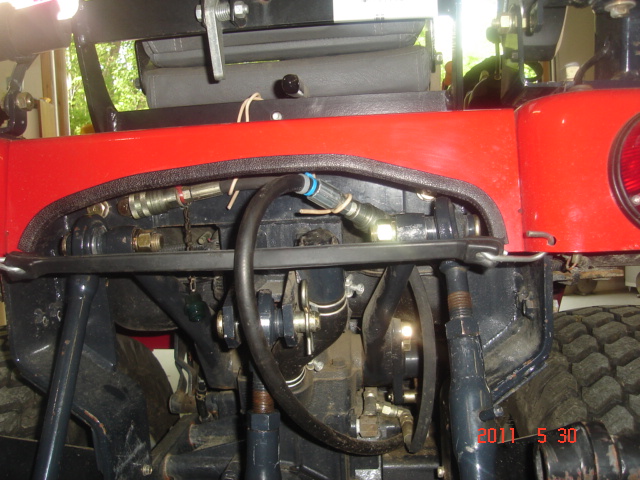

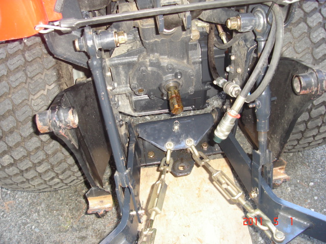

Ditto on the sight glass- it's really hard to see with the BH on, but there's one "hole" through all that red steel back there, that if you get your head in just the right spot, you can see it. A flashlight is pretty much required. And yes, get the whole shootin' match as far as repair manuals. Money in the bank. Too bad they didn't come with the tractor....
Here's a couple pics: The sight glass is just to the left of the rear PTO driveshaft output, and you can just see the fill port (black plastic tube with plastic screw-on cover) behind the black bungee, directly beneath the hydraulic line with the blue and white tags on it. Hope this helps. WBB in NH
