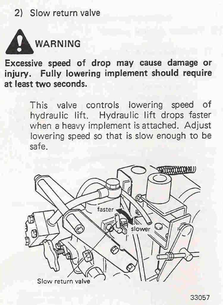

How big is the lever ? Does it look like this?
Bruce

No, it is on the other side of the seat. If you were sitting on the tractor, you would reach this lever by reaching down with your left hand, not right... (well, that is if the machine was big enough to allow you to do that!:p
I'll take a photo of it and post here in a few days. The Murray publishing book I just ordered from Hoye does not mention this lever at all, so I'm thinking maybe someone might have put a 1500D hood/decals on something else, or maybe draft control was offered as an option for a very brief time during the 1500s production. I dunno.
