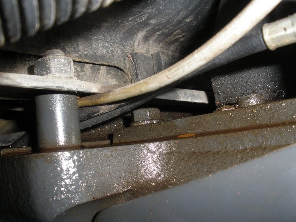

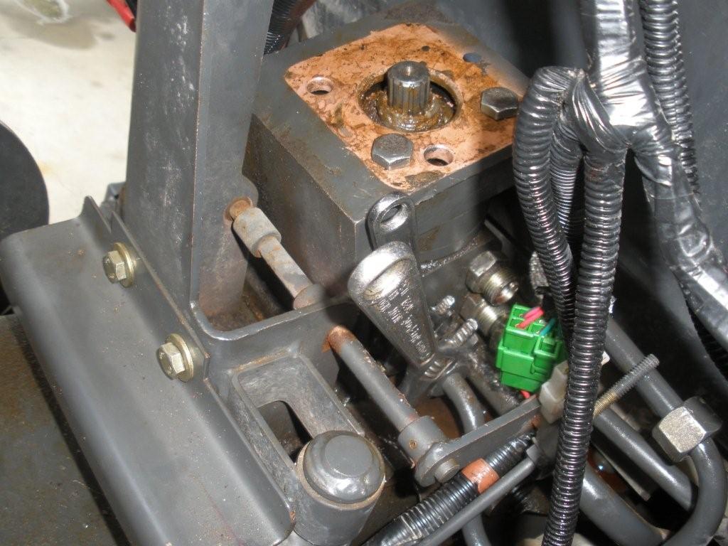

I have a '93 early model 4500 with a whopping 160 hours. Last weekend it started squirting PS fluid from the top of the steering column. I purchased the manual and started the procedures to remove the hydrostatic steering unit. My first problem is that I can not manage to remove a connection next to a piece of tubing that is apparently welded or brazed into the HSU (see photos 1 and 2). The quarters are so cramped that I can't get sufficient swing radius for a wrench. I took a 7/8" box wrench and cut open the end to go around the tubing but the clearance between the fitting and the tubing next to it is so close that the wrench won't go on. A standard wrench is too thick/stubby to get in at anything other than an angle too short to turn the fitting. Any suggestions as to how to remove this connection would be appreciated.
My second problem starts after I figure out the first. At this point the manual simply states to remove the four bolts that hold the HSU bracket down and remove the entire unit. The problem I see is that the two forward mounting bolts are under the fuel tank with insufficient clearance for access and removal (see photo 3). It appears that even if the fuel tank were loosened and lifted it would hit the tractor body within a fraction of an inch, not rising enough to allow removal of the bolts. I'm hoping that there is sufficient clearance to remove the HSU from the bracket out the side, but that even looks very, very difficult.
Does anyone have any experience in this HSU removal operation? Your comments and suggestions are appreciated. I can't believe how user-unfriendly this design is, but I'm sure it went together easily.

Looks like you need an offset angle wrench or a flared crows foot. The angle wrench has two different angles and are different angles than an open end or combination wrench. This wrench and an open end wrench should do the job. If not............a Bluepoint flared crows foot wrench (really a socket that can be used with a ratchet or breakover bar) from Snap On should be able to get in to do the job. Those bolts that lack clearance might just be an optical illusion until you get everything loose and try to remove them. Be careful prying any bolts out and back in as you may damage the threads enough to not start the bolt upon installation.

Thanks Brandi; I'll check it out. But first I'm going to try to find out if I need to take apart the entire tractor to get to this first. I just looked at a 5500 that was in the shop and M&M seems to have rectified the problem in subsequent units by relocating the interfering linkage, getting the front mounting bolts out from under the fuel tank, and raising the HSU enough to take it out without removing the entire bracket. Those small changes could have saved a lot of R&R time.
