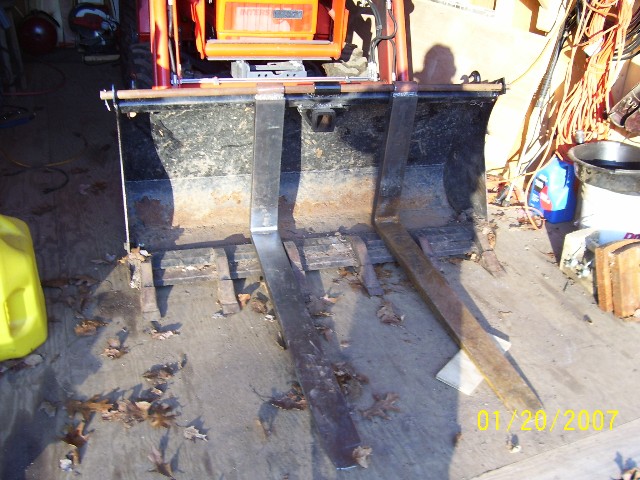

Here is my version of bucket forks. I got some towmotor forks for free and went from there. They work real good for lifting logs. The only thing I don't like is I had a pallet box full of wood on rough terrain, a little tippy. Can't wait to use them for brush.

nice work what is the material for the fork pin? pix looks like wood
   / Another set of forks
The pin is 1" rod. The tubes on top of the forks and the center support
is 1 1/8" id heavy wall pipe. I figured I'd go bigger on the pipe in case I
bend the pin.
