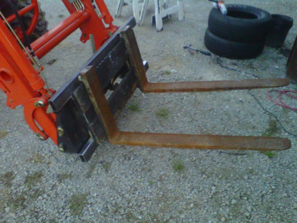

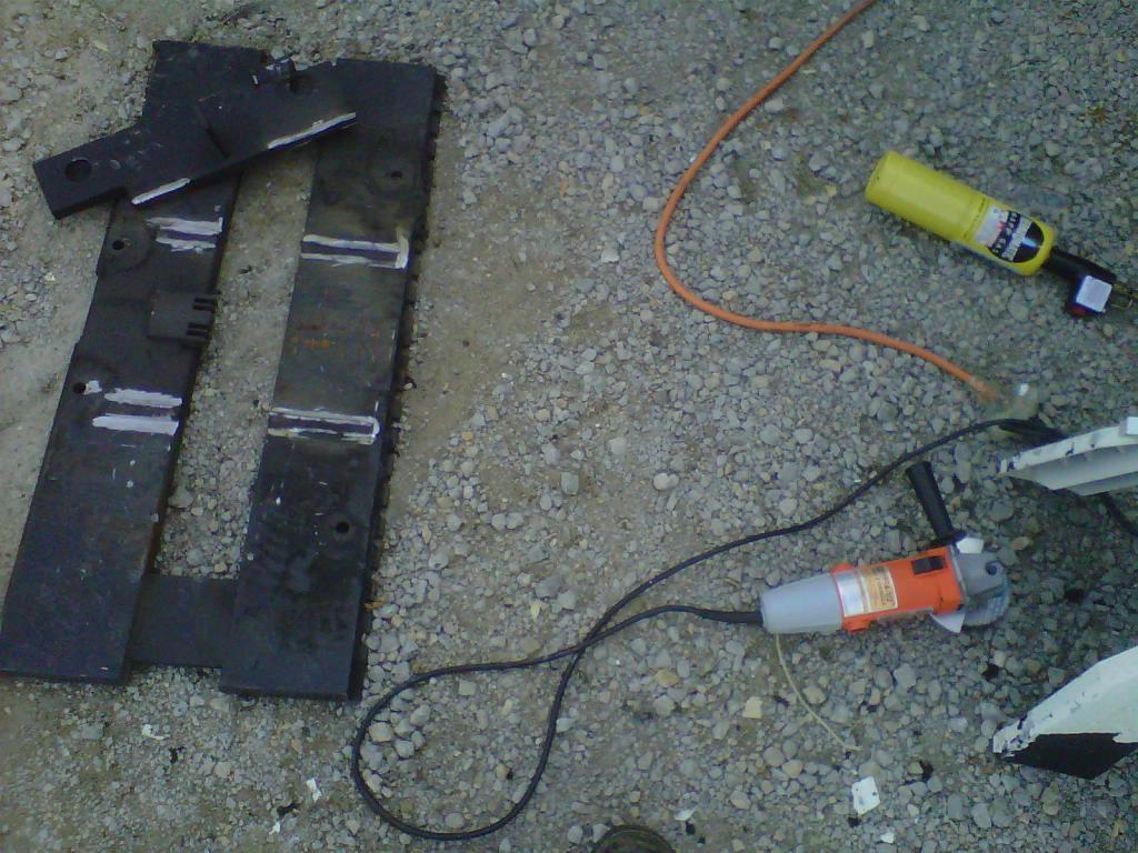

Thought I'd share my project/adventure. Being on a limited budget, I wanted a set of forks but didn't have $600+ to give. I must say that I was helped by a good friend who has a forklift service and repair business. I shared with him what I was looking for and he ended up giving me a set of 42" forks and the carriage off a forklift that was being scrapped. So, off to building my set of pallet forks I went.
Here is what I had to work with and as you can see, in the end, I have a functional set of pallet forks.
PLEASE keep in mind that I don't have a metal shop and used the tools I had at hand (or acquired inexpensively).

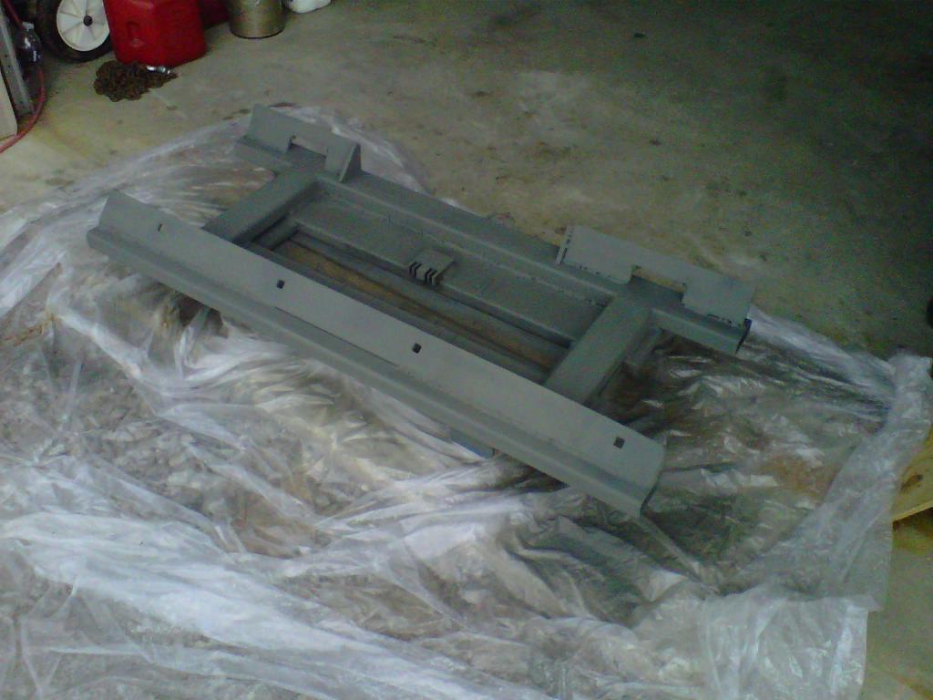

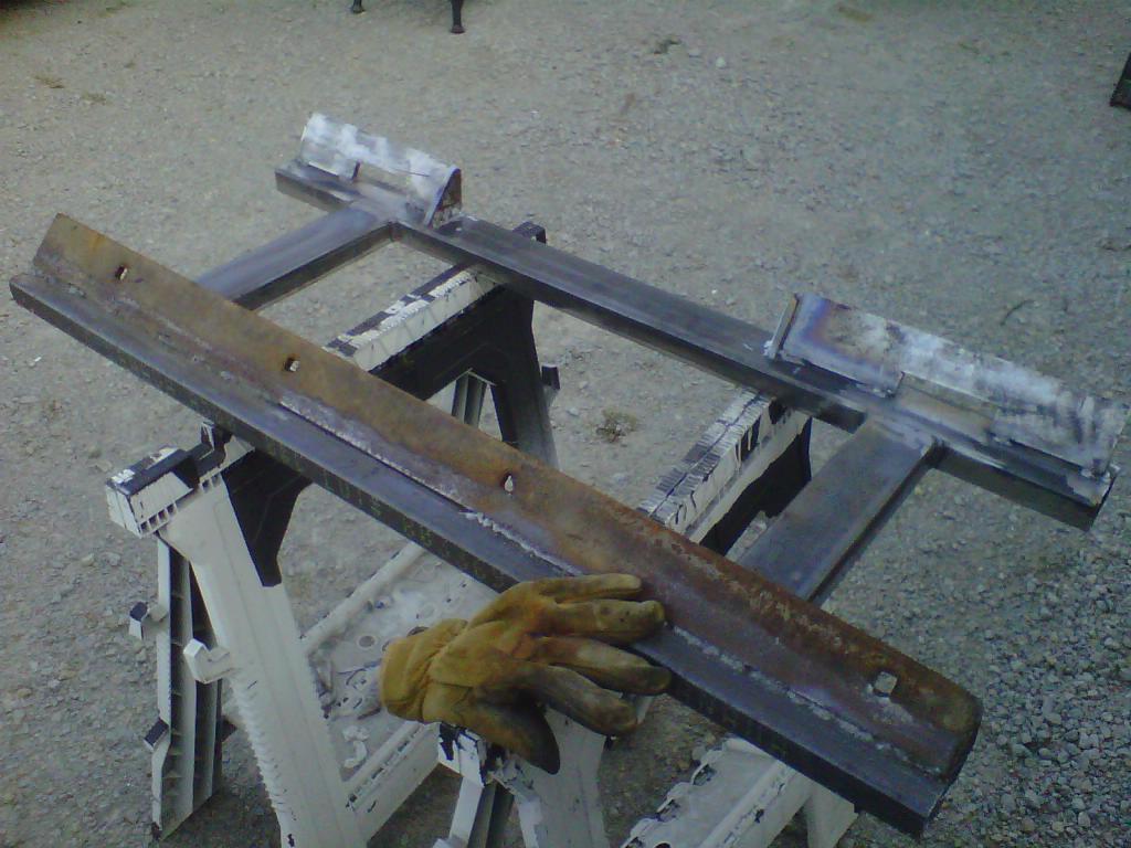

I cut off the vertical supports from the carriage. One interesting point here is that the total width of these are 35" whereas a regular Q/A pallet fork is 45" wide. With this, I decided to fabricate a frame to attach the carriage to and that was wide enough for my quick attach. Thus, I used 2"X3"X3/16" tube steel. I opted to go this route VS a Q/A Mount plate b/c of (1) cost & (2) I hope to adapt it to a 3-point hitch as well. I'm just at $100 - $125 in out-of-pocket costs.
I had some metal snow plow blades (another free resource) so I cut that up and used that material to make the quick attach mount.

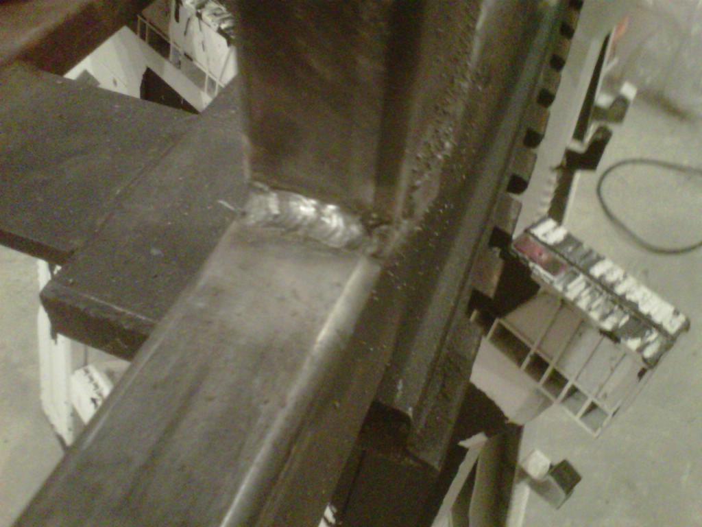

Once that was done, then I welded the carriage to the frame, tested it and then prime and paint. As for the welding....this was my FIRST project and I know the welds look crappy but they're working! (I know some will want to critique the welds and that okay so long as you know I'm a novice). I did spend a lot of time reading on the welding forum here and I will tell you that if you have a HF welder (it did just fine for me), go get some "American" flux core wire and don't use the HF material. Difference B/W night and day!!!! I switched out to Lincoln Electric wire and what a difference!!!! While not shown in the photo, the top bar of the Q/A has 4 angled supports across it (I basically copied the design of my bucket).

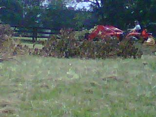

Anyhow, I need to add a frame on the side and top so materials won't fall back but the main purpose of the forks were to lift our 330 gallon plastic tote to carry about 175/200 gallons of water thru the yard to water a dozen trees. Since then, I just used them at my father-n-law's place to help clean out a fence line and WOW.....the debris and crap I picked up using them!!!! I like them so much, I'm now contemplating adding a "claw" on the top and make a grapple out of it??? If I do that, I'll make it so I can remove them and have 2 attachments in one. They are so handy, I'm sure I'll find more uses for them as projects come up??!!
