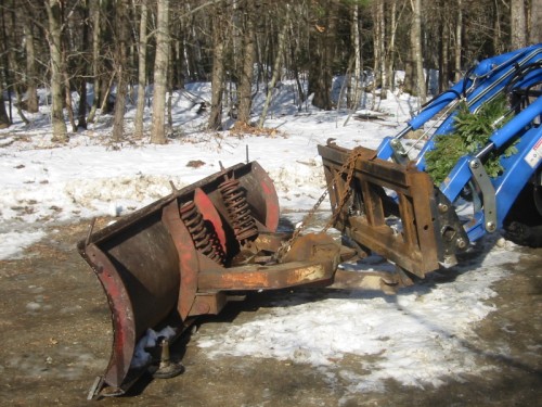

Thought I would try a posting with images...please bear with me.
This is a no-name 8' plow that I had on an earlier tractor. It was mounted on a Fischer fixed plow frame before. I hooked it up to a heavy-duty fork carrier that I had made previously....as a quick way to be able to use it this winter. It hasn't gotten a huge amount of use this winter (52 degrees today) but it seems to work pretty well. I added skid shoes to it which combined with the bucket roll function make it pretty easy to find a good angle of attack for the plow.
It is set up for hydraulic angle but I took them off for now...I have all the tubing/hoses/valves/remotes for another function...just seem to lack time.
Have incorporated various ideas from the folks on TBN..thanks

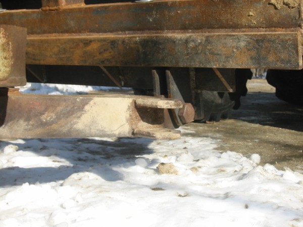

Picture of the bar that is bolted to the bottom of the fork carrier with 4 bolts. Bolted to create a failure point and so that I can take it off in the summer an use it for forks or other attachments

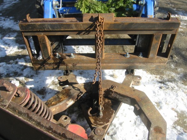

Last one...looking toward the quick-attach on the FEL
