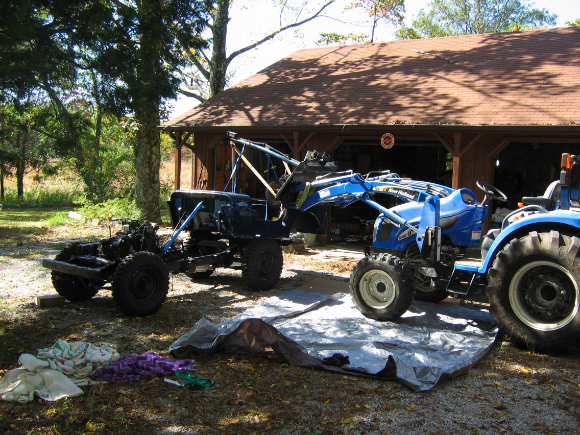

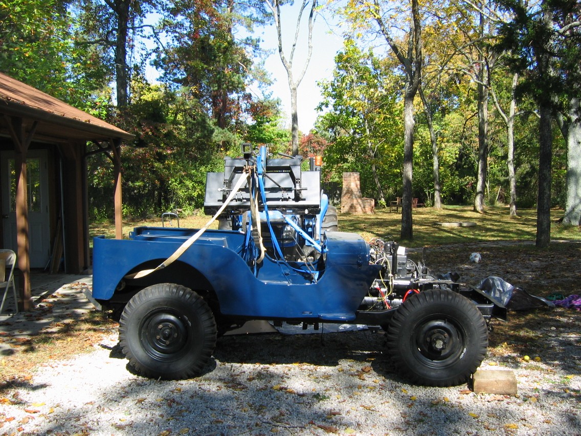

We are restoring a 1949 Willys jeep. We are now putting it back together and needed to place the tub on the frame. This is normally at least a four person job to lift the tub high to be able to slide down the steering column and to tilt it to clear the transmission and transfer case shifters. We were a couple of human bodies short, so we used the tractor instead.
I had put a HF QA on a FEL plate and attached a short boom pole to it. We added some web straps and we had the perfect tub installation tool.
Just another reason to have a FEL!

Nice use of the tractor. Most fellows who have used their tractor for body work usually include an "Oops" I didn't think the { attachment} stuck out that far.
Are you going to update us on the jeep restoration Please??:D:D

We are working on an update. Lots to report. I'll include the 1-16 plow we picked up to use with the jeep. In theory we should be able to pull it or a 2-12.

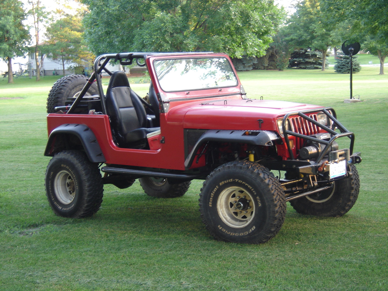

I definitely like the jeep projects... here's a shot of mine. I did the frame and all...

Great looking jeep. I really want to return my 79 CJ7 to "daily driver" status. Maybe in a couple of years.
I wonder how many jeep owners we have on TBN?
