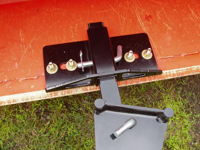

Sandy,
Here's a pic of what I built to move my trailers. I welded it up from scrap I had, plus I had an unused receiver and ball. I found that if I curl the bucket up, I can see the ball over the top of the bucket. Makes it easy to hook up. I snatch the hitch, then uncurl to level, and move either my boat trailer or utility trailer.
It really is easy to see what I'm doing; I only have an inch per side for the utility trailer to clear getting into the backyard.
When I need to move dirt, I simply take the receiver out and the plate doesn't interfere.
Enjoy.
Ron

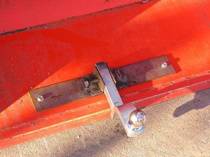

Re: Another use for the \'Bota
Kinda looks like mine, except I cheated and 'bought' a step and tow truck hitch and some grade 8 bolts!!
