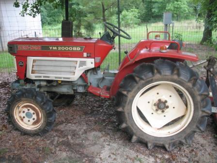

Super_Chief
Jul 5, 2008
23
Cadwell, GA
Ford 801/48 8N
Advertised as YanMar
ZEN-NOH YM2000BD
#$3500
757 hrs
Probably will be gone before I can gather the cash.
Any input would be appreciated

It's a Yanmar, newest of The YM2000's. It has gauges instead of lights on the dash, larger side screens, steel fuel tank instead of plastic, more foot room, plastic headlight door, and a few other things.

I'll let someone else explain the Zen-Noh part and the spec differences vs a 2000D. Sometimes I think some guys on here can tell you the names of the workers who built the thing.
I have a 2000BD which is very close to a 2000D. The steering wheel has a greater number of splines than a 2000. The BD has guages instead of lights, I think the radiator housing is the different. The decomp cable is longer on a BD. The side grilles covers the entire side of the engine.
The only real problem I have had is knuckle seals and the alternator which I replaced with a Datsun 510 one for $24.00. The steering wheel I did too mostly for cosmetic reasons. I added a ROPS, which the 2000D ROPS fit with no issues.
As far a price goes, I paid $2500 with a bush hog. I had the charging system to fix though. I assume this isn't a dealer so I'd check the usual stuff carefully.
